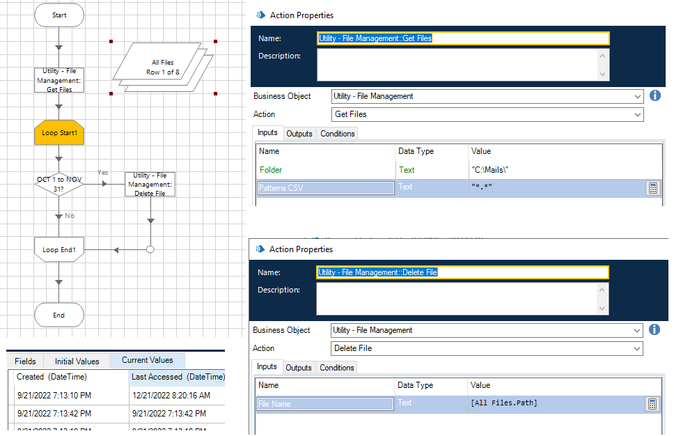

I know you can use utility management to delete files, but I want to delete files within the range they created. Example I only want to delete files that are created in between October 1 to November 30 in a folder. How to do this?
Ajithran Balasubramanian
Hi
You can use Utility - File Management VBO => Get Files Action - PFB
Condition (Decision) you can create it based on your use cases scenario

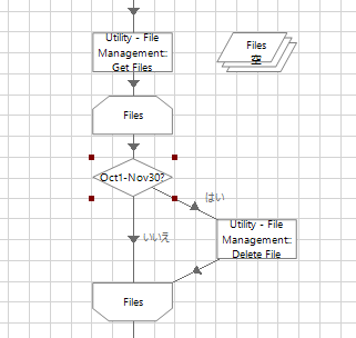

sumire
Is it like this?
[Files.Path] (text) full path of file
[Files.Created] (date) file created date

Hi
