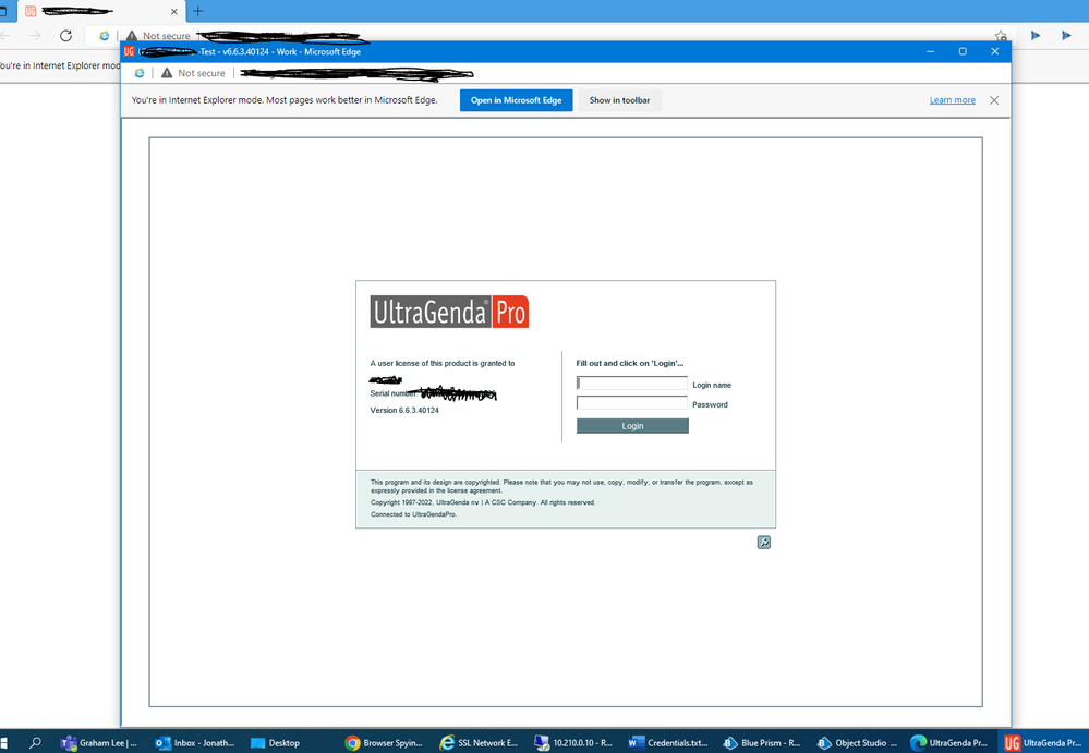

I have a browser application, opened in Edge, with IE compatibility turned on.
The application launches in Edge, then a second Edge window opens with the login screen. I can spy the second window using Win32, but spying the elements in Browser does not work. In fact, all modes are not able to see the elements. IO have installed the extensions inc 7.0.1, but no luck.
Does anyone have a suggestion?

Screen shot below:

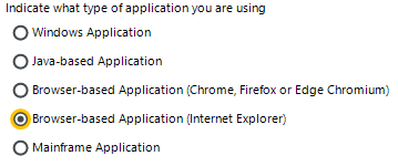

I know on other versions of BP, there is an option like this:
I know it has fixed an issue of not being able to spy , for another client.
On the community edition, this option does not seem to exist.

I was wondering if you have ever used Internet Explorer browser to work with this website? If so, did you have any success in doing that?
Another thing I would suggest you look into is on how the page is constructed in the new popup. Using Developer Mode to see if you can find any clues from the backend HTML. Things like the presence of an outer iframe is one of those things you can look into.

Gopal also makes a very good point - the application type in the VBO needs to be 'IE', even though you're using Edge. With compatibility mode you don't need the extension because BP is communicating directly with the browser. And if you look in Task Manager you'll see that iexplore.exe is there under msedge.exe - that's what compatibility mode is - a hidden instance of IE running inside Edge.

I have followed Gopal's advice and selected IE in the application wizard. That worked successfully.
