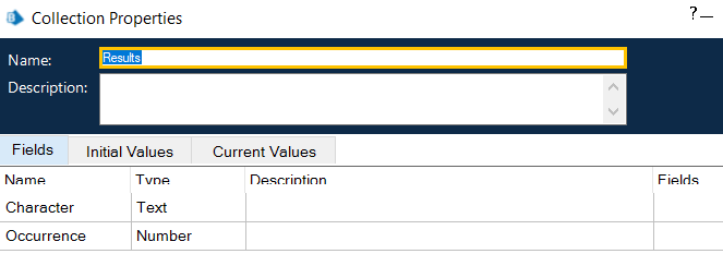

Once, you got this collection we would iterate through this collection using a loop stage. Now create a predefined collection called 'Results' with following schema:

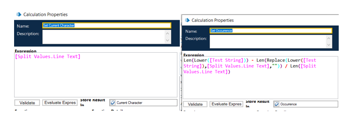

If the value of the flag is False, we would set two data items called as 'Current Character' (Text) and 'Occurrence' (Number) with the following calculation stages:
The logic here is pretty simple: for current character we would simply set up the current character row which we are getting from 'Split Values' collection whereas for the occurrence we will use the logic as:
What it does is let say you have a word called as 'Apple' and we need to get the occurrence of the letter 'p' so we first take the length of the word 'Apple' which is 5 and the we replace the letter 'p' with blank in that word so that the word becomes 'Ale' and then we get the length of the resultant word which is 3. So now we take the difference between the lengths which is 5-3 = 2 and we divide this by the length of the letter which we need to find the occurrence for that is 'p' which will be 1.
Hence, the occurrence is equal to 2/1 = 2 so 'p' occurs 2 times in the word 'Apple'

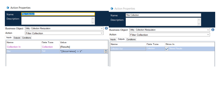

Now we can use the 'Filter Collection' action from 'Utility - Collection Manipulation' and use the following filter query:
Now you will get a collection called 'Filtered Results' with the following values:
So this is basically the letters which are occurring more than one time in our word. Now you can simply iterate through this collection and set up a blank data item of text type called 'Joined Text' with all these letters:

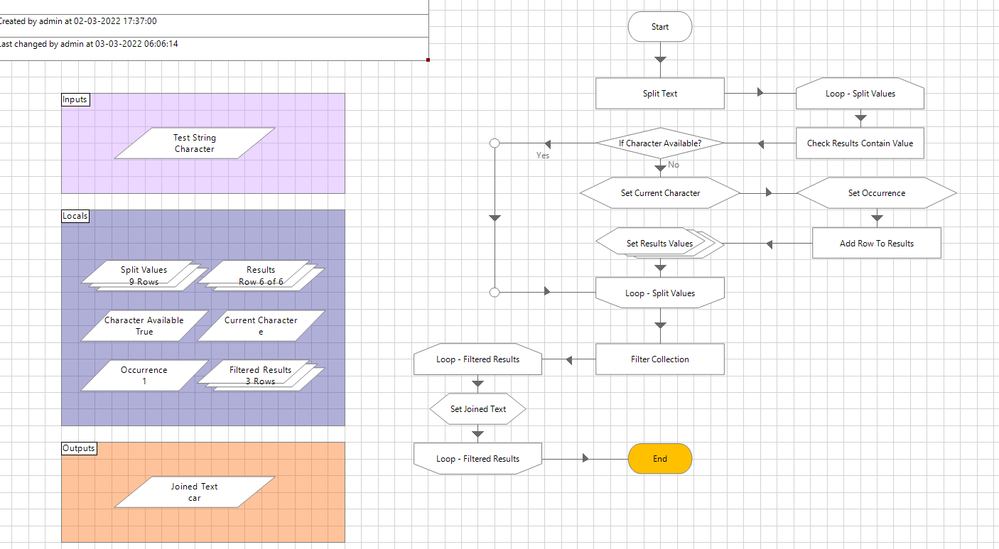

Hence, at the end of the loop stage you will get the result as:
You can refer to the attached process for more details:
Len(Lower([Test String])) - Len(Replace(Lower([Test String]),[Split Values.Line Text],"")) / Len([Split Values.Line Text])
"[Occurrence] > 1"
