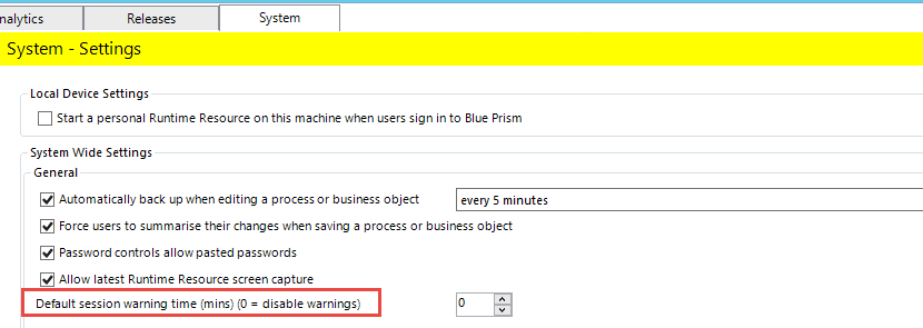

osanchez
Hi Harit .This can happen when the runtime resourse was hung at that moment, when you lose connection and restart the virtual it remains in the warning state,
make sure you connect remotely to the virtual runtime and verify that it has running the automate / resourcepc / public in the correct port.
If this is not the case, restart the blueprism server service on the Application Server to release the job. Then in the system configuration
section in blueprism it has an option that you can modify
to increase or decrease the time for generating the warning. it called "deault session warningn time (mins) (0=disabled warnings) I suggest that you put between 5 to 10 minutes
Hope that be helpfull

Hi Orlando, thank you for the reply but I don't think this is issue because of default warning session settings. The same configuration is there in other DEV Vms but there the process is running fine. for you I tested my process in debug mode and getting this error  - "AppMan has stopped working" due to which process is killing the automate.exe in debug mode and in control room it is making the process stuck. Kindly check the screenshot and advise me if you have experienced the same issue.
