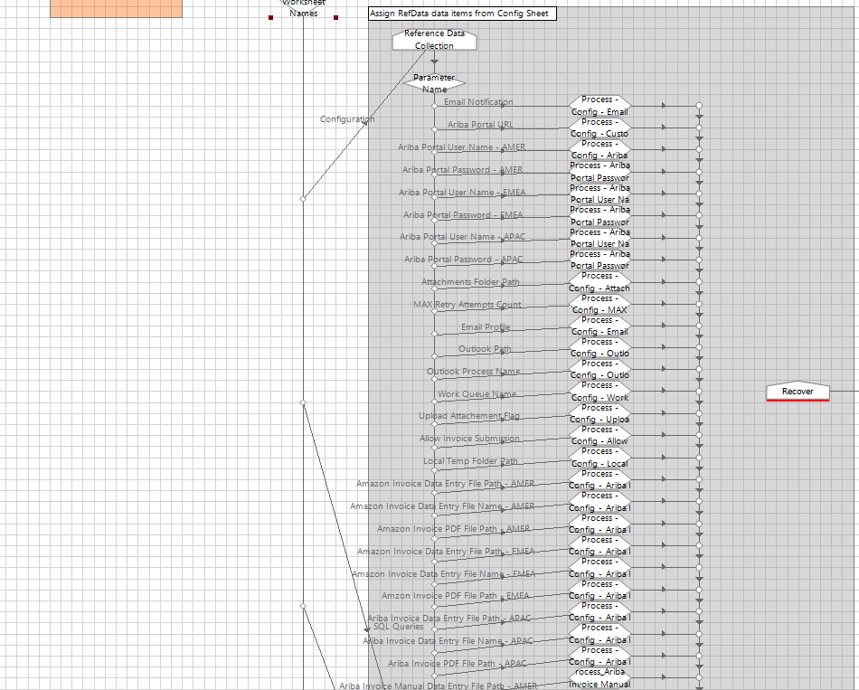

Is there any option to prevent  resize or re arrange of branches of choice stages. It's a pain when there are lot of choices.
20025.pngThanks in Advance !

Hi Amlan,
YES, it is a pain, and NO you cannot change that behavior. Splitting large choices in smaller ones may help readability and diminishes your work if something changes in one of the choice values.

Hi Amlan,
I have found if you us 2 blocks between the top of the stage and the first choice and the same spacing for the last choice.  Then use 3 blocks spacing for all of the remaining choices, it will retain the spacing.

Hi Leslie,
The 2-3-3-2 trick doesn't work for me on version 6.7.1. Perhaps something in a later version?

Hi Paul,
We started working with version 6.8 and it worked with that version.  It must have been an update addressed in this version.
