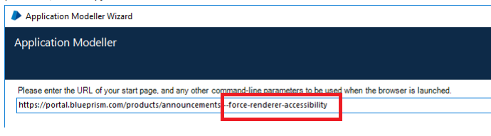

You might want to try adding command line parameter :
Henry Li
When I do this I get a chrome response of  404 page not found error
Esteban Montesinos
Are you using BP 6.7.x or BP 6.8 ?
IF so, you might want to add "" to embed the address field
