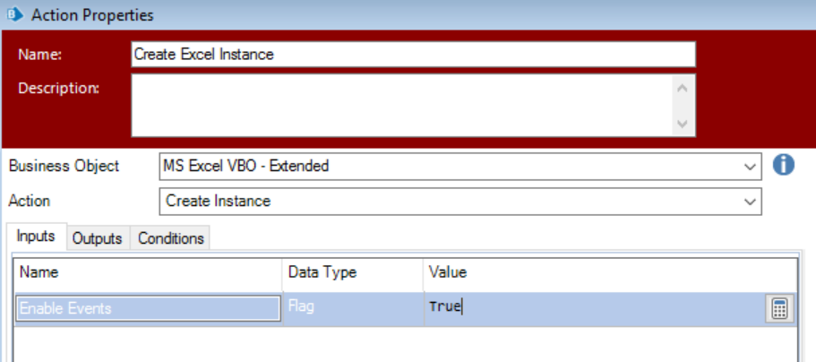

I think on the create instance if you enter True for events enabled this should fix that problem.

I entered "True" for Events Enabled on Create Instance:
Unfortunately, the pop-up still appears:
To give a bit more context, once the Excel file has been opened, I need to write some data into the file. However, due to the Read-Only pop-up, I am unable to do so.

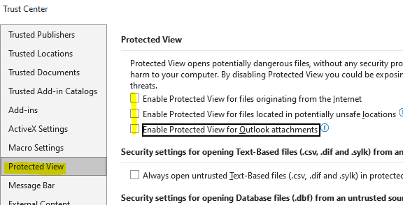

I guess you're using the 2016 version of excel and your file is hosted on SharePoint, mostly we're seeing this alert (READ-ONLY We opened this workbook read-only from the server). If you try to open that file it'll show the below alert and it won't allow saving (you can able to save in a different name)
This alert is used to prevent locking out other users from editing the file
Always loop your IT Team
1. Try to update the excel version/build => check the fixes https://learn.microsoft.com/en-us/officeupdates/beta-channel and https://learn.microsoft.com/en-us/sharepoint/troubleshoot/lists-and-libraries/files-open-as-read-only-and-cannot-check-in-or-out
2.
3. Check the file access, Is USER or BOT has elevated right to write
https://support.microsoft.com/en-us/office/why-did-my-file-open-read-only-3ab4b792-da50-4b38-8628-14c64e1f1d15

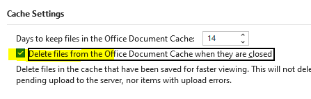

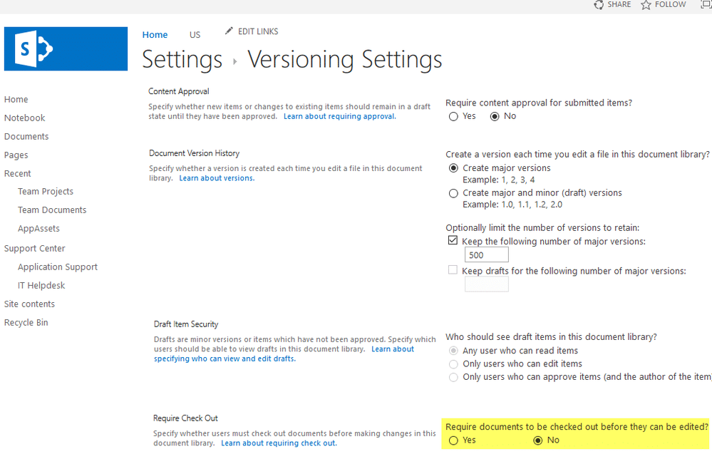

7. Disable the checkout/in option
