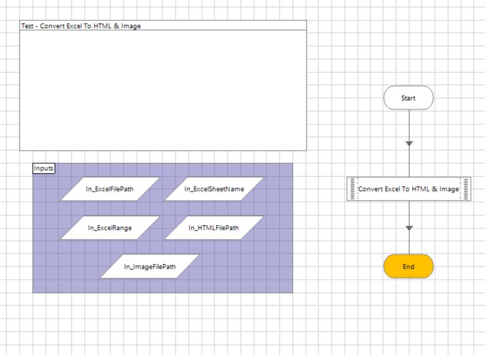

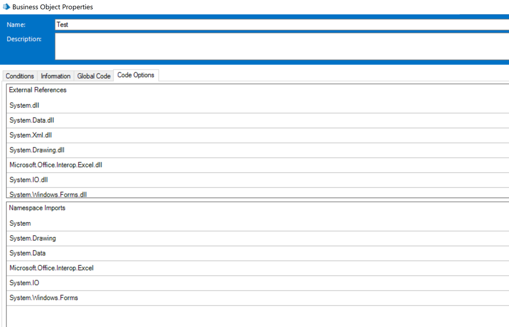

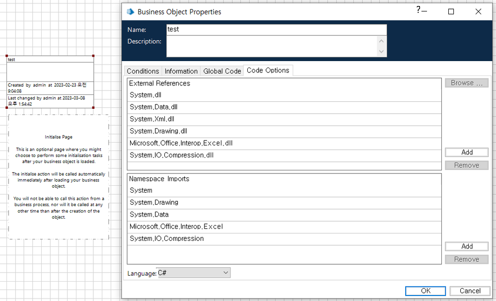

1) First create a new business object and have the following external references and namespace imports added:

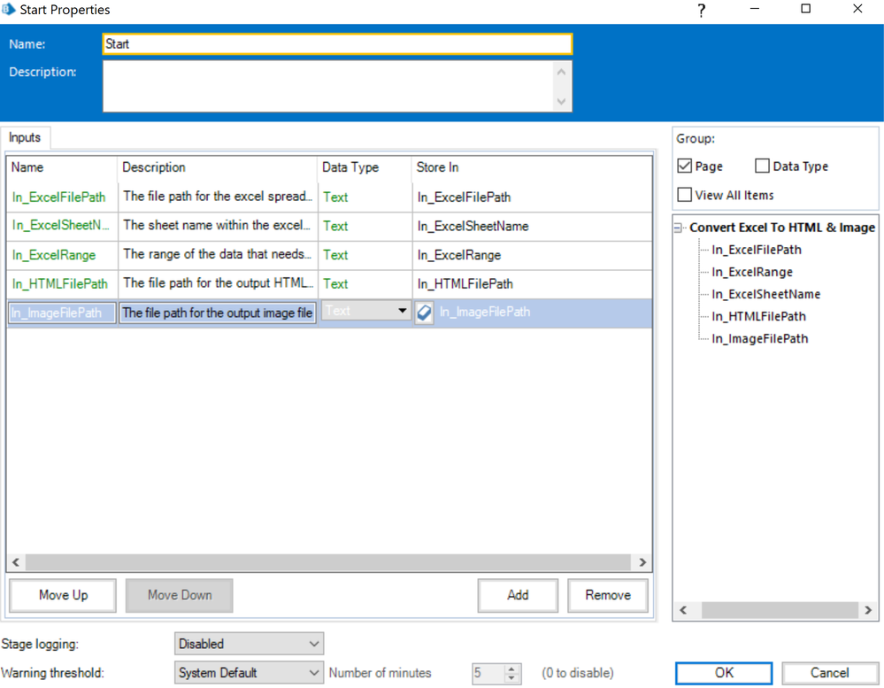

2) Now, create a new action named: 'Convert Excel To HTML & Image' action with the following input arguments:
  • In_ExcelFilePath: The file path for the excel spreadsheet where the range needs to be converted to HTML and JPEG format.
  • In_ExcelSheetName: The sheet name within the excel spreadsheet where the range needs to be converted to HTML and JPEG format.
  • In_ExcelRange: The range of the data that needs to be converted to HTML and JPEG format.
  • In_HTMLFilePath: The file path for the output HTML file that needs to be generated.
  • In_ImageFilePath: The file path for the output image file that needs to be generated in JPEG format.
3) Now, you can use the below code in the code stage with the input arguments:

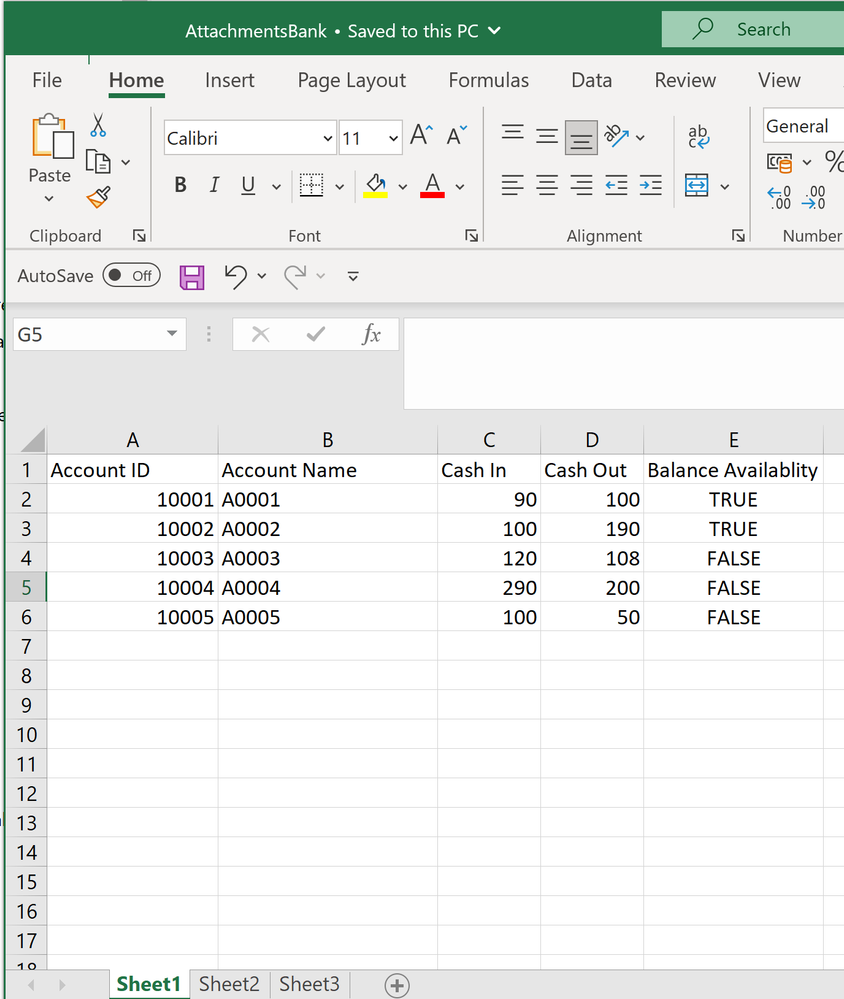

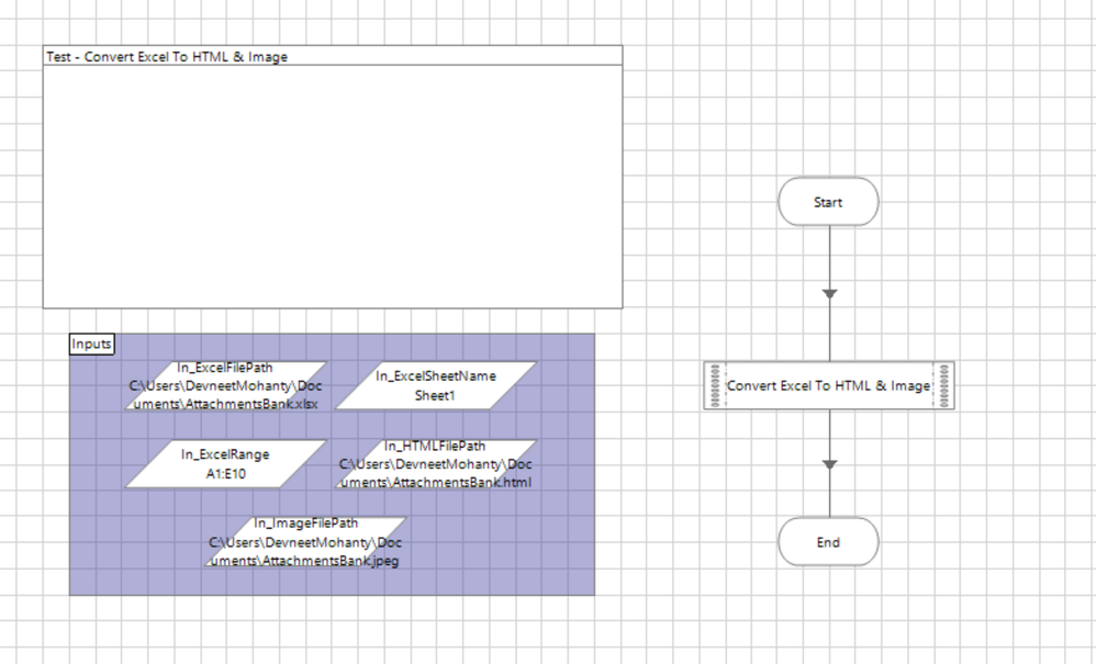

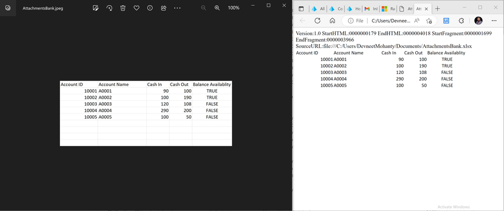

Here, for my supplied arguments as below, you can see the sample output generated:
Inputs:
Outputs:

Hi, @devneetmohanty07
The issue has been resolved.
I really appreciate your help !!
