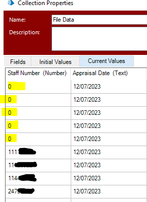

In my process we download a compliance report , the only data we need from this report is the Staff Number and the Appraisal Date.
The report is a csv file and we put this into a collection. The issue im having is that some of the staff numbers is in the report have a dash in them eg 123456-7
The data type for the Staff Number is automatically pulled through as (Number) in the collection therefore any staff numbers that have a dash in are coming through as 0, i know the reason why its doing this is because any with a dash in should have the data type (Text) not (Number)
Does anyone know how I can convert or change the data type against the Staff Number field to be (Text) so that any staff numbers with a dash in them will be put into the collection NOT as 0.

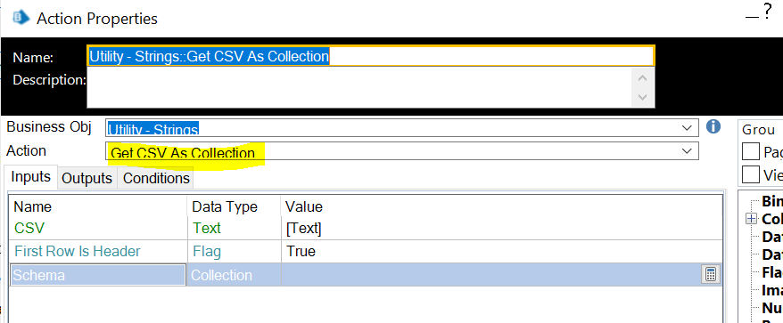

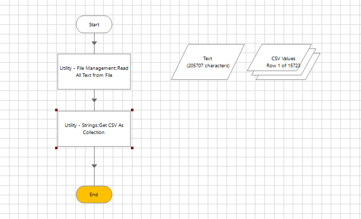

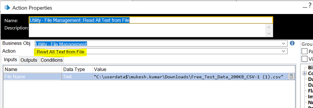

Hi @Frankie Legg - Utility File Management - Get CSV as Collection uses OLEDB to pull and parse the CSV data - which by default is taking the source data format to the output collection, to avoid this formatting issues you could use two actions - Utility File Management - Read All Text from File - Read everything as text values first and then do the Utility - Strings : CSV to Collection, see below :
Example Output Collection as below :
