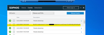

This could be related to an issue we just solved.
Please check your anti-virus software. We solved this issue after we found that our Sophos Antivirus was stealthily blocking access to the AppData\Local\Temp folder. Below is a screen shot from our environment. Somewhere along the way, Sophos rules may have been updated causing it to treat any write operations to \temp as a malicious threat. Worst part about this is that there were no warnings or popups warning us about the threat. If you have a different AV software, then you may want to ask your security team to add Blue Prism as an exception to the rules so that you don't get cut off from the AppData\Local\Temp folder.
Also to note: This is a situation with VBOs that contain the code stage. That's why it would appear to work when running once process (because it maybe using a VBO with no code stage), when you have errors with other processes at the same time!
I hope this is truly the situation on your end. Check your Antivirus/security software first before embarking on needless testing. We spent nearly three days on it, and no fixes in the code seemed to help. There is most likely nothing wrong with Blue Prism or the VBOs.
