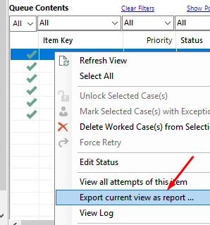

How do you create queue/exception reports and make them show up in the control room?

Hi Pedro - One option is to filter the control room view and then export a CSV:

John__Carter
