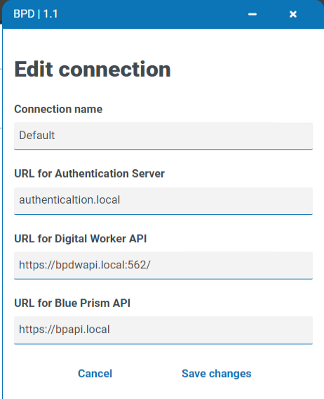

Hello all,
While setting up Blue prism desktop product we are not able to setup a successful connection.
All the required products are installed on the machine and Hub is working.
BP API is installed with default settings on port 443.
BP DW API is moved to port 562 to avoid any potential clash as mentioned in installation video but not in the guide.
Any idea what are we missing here or how to check logs? I do not see any event viewer entry for the same so looking for help.

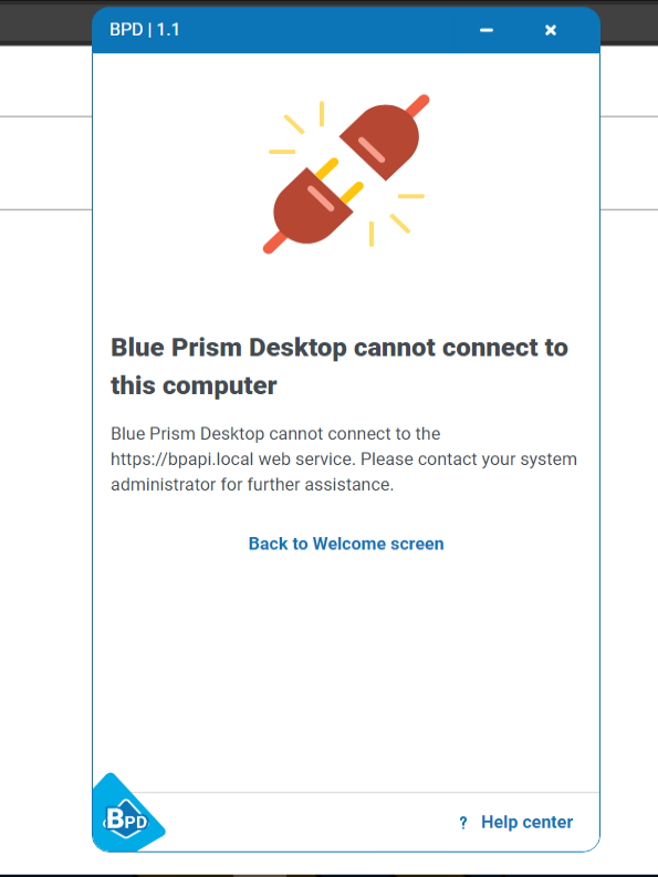

Where can we check logs for Blue prism desktop?

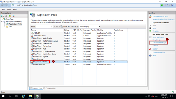

Hi Tejas,
Did you get a chance to change the application pool identity for Blue Prism desktop API in ISS?
 Please see the screenshots below for your reference.
Ram Prasad Gajula
Tech Lead
EY
Bangalore
Yes that is updated as mentioned in guide

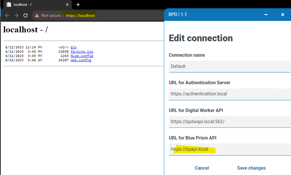

Something is off with BP API I doubt!
If I browse BP API from IIS it opens this-
Thanks & Regards,
Technical Lead

Yeah, can you help me with what needs to be fixed with BP API? Or how can I find what is off with BP API?
Thanks & Regards,
