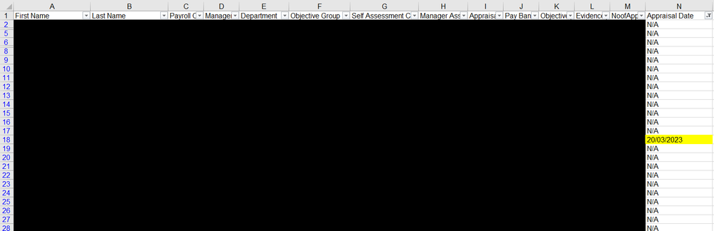

I'm building an automation where the bot will copy appraisal dates from a report and input them input them into our ESR system.
The appraisal report is in excel format - and i need it so that any staff that have 'N/A against  the 'Appraisal Date' column are removed so it only leaves staff which have dates . This action will take place before populating it to the work queue as i don't want any staff who have N/A to be sent to the work queue as the bot wont be able to upload any info into ESR if the Appraisal date show's as N/A.
An example of the report is below - i have removed any sensitive info and you can see in column N is the Appraisal Date ifno
I have used a delete function in the excel VBO however it just moves the data up in column N and doesn't remove the entire row which will cause issues as if the column moves up the dates will be pushed up to the next staff and will mis match ..( if that makes sense)
I need it so it searches the column in N and if it says 'N/A' remove the entire row against  the staff.

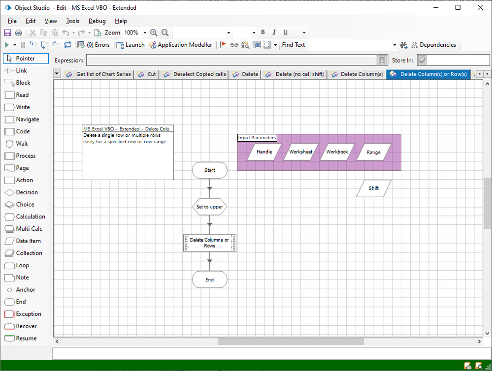

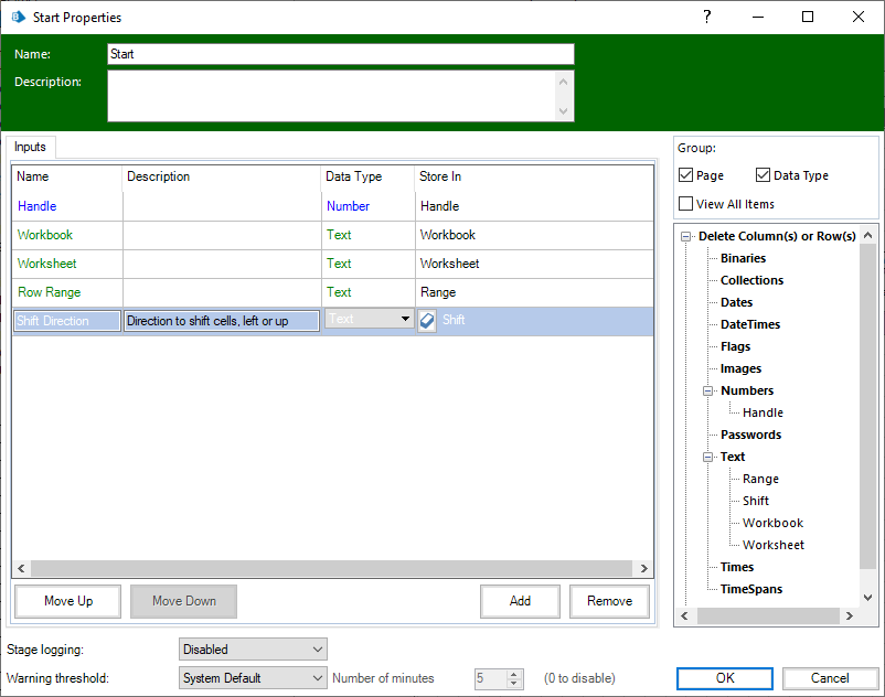

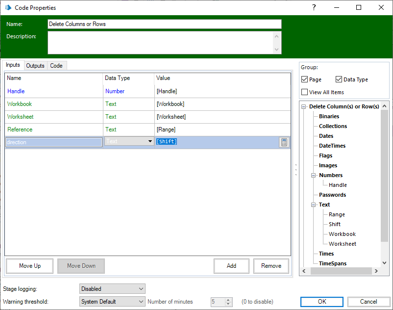

The delete action will only delete the values from the cells and not the rows but if you need to do this within excel you can build a custom code stage. I previously built one you can utilise, the code is below along with screens of the flow/inputs etc. You can use this to delete columns or rows, if you are deleting entire rows then the range you enter is only the row range e.g. 1:6 would delete rows 1-6. Or for columns A:C etc
Dim wb, ws As Object
Dim strDir as String = direction.Trim().Substring(0,1).ToUpper()
Dim dirn as Integer = 0
Dim excel, sheet, range As Object
wb = GetWorkbook(Handle, Workbook)
ws = GetWorksheet(Handle, Workbook, Worksheet)
wb.Activate()
ws.Activate()
excel = ws.Application
sheet = excel.ActiveSheet
range = sheet.Range(Reference)
range.Select()
Select Case strDir
Case "U"
dirn = -4162 ' Excel.XlDirection.xlToUp
Case "L"
dirn = -4159 ' Excel.XlDirection.xlToLeft
Case "R"
dirn = -4161 ' Excel.XlDirection.xlToRight
Case Else
Throw New ArgumentException("Invalid Direction: " & strDir)
End Select
range.Delete(Shift:=dirn)
'If direction = "UP"
'range.Delete(Shift:=-4162)
'else range.Delete(Shift:=-4159)
'end if
#MVP
