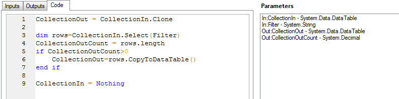

johan.m
I agree with Paul's solutions
You can try our "Filter" action that we rewrote to use less memory :
