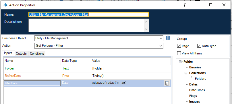

Hi @Tejaskumar_Darji
I duplicate and change little bit the "Get Folder" action to create "Get Folder - Filter" action in the "Utility-File Management" VBO.
Find attached to this post.
For use it. Only need to put the two dates that you want to filter.
I try it and works pretty good.
Hope this helps you!
See you in the community, bye 🙂

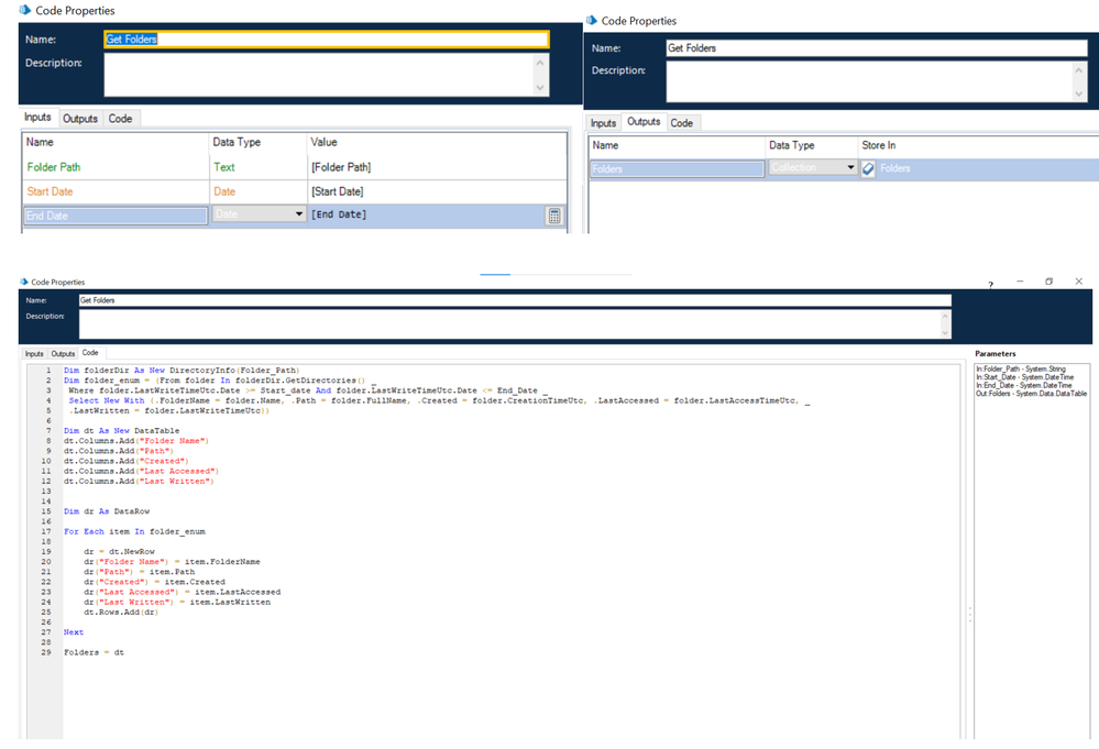

Hi Tejas,
Not sure if this will be able to solve the issue as I didn't test the same with 1 lac folders 😛
But well, you can give it a shot as I am using LINQ queries with Folder Retrieval as a part of the below custom code stage. I am using LINQ queries as it can speed up your collection filtering by miles.
You can create a new business object and add the below External References ('System.Data.DataSetExtensions.dll', 'System.Core.dll') and Namespace Imports ('System.Data.DataSetExtensions', 'System.LINQ', 'System.IO' and 'System.Collections.Generic') on the Page Description stage of your Initialize action for the LINQ queries to work properly. Also, ensure that the language is selected as 'Visual Basic':
Once you have the updated code options as shown above, create a new action named 'Get Folders By Filters' and pass three input arguments, Folder Path (Text) and Start Date (Date) and End Date (Date). Based on the field names that you provide the unique records will be fetched from the Input Collection. Also, set an Output parameter as Folders (Collection) for this action as shown below:
Add the code stage and use the below code with the input and out arguments as show:

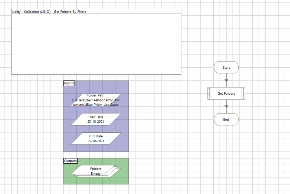

The run results are as follows:
Input Arguments:
Output Result:
Dim folderDir As New DirectoryInfo(Folder_Path)
Dim folder_enum = (From folder In folderDir.GetDirectories() _
Where folder.LastWriteTimeUtc.Date >= Start_date And folder.LastWriteTimeUtc.Date <= End_Date _
Select New With {.FolderName = folder.Name, .Path = folder.FullName, .Created = folder.CreationTimeUtc, .LastAccessed = folder.LastAccessTimeUtc, _
.LastWritten = folder.LastWriteTimeUtc})
Dim dt As New DataTable
dt.Columns.Add("Folder Name")
dt.Columns.Add("Path")
dt.Columns.Add("Created")
dt.Columns.Add("Last Accessed")
dt.Columns.Add("Last Written")
Dim dr As DataRow
For Each item In folder_enum
dr = dt.NewRow
dr("Folder Name") = item.FolderName
dr("Path") = item.Path
dr("Created") = item.Created
dr("Last Accessed") = item.LastAccessed
dr("Last Written") = item.LastWritten
dt.Rows.Add(dr)
Next
Folders = dt
Input Arguments:
Output Result:
