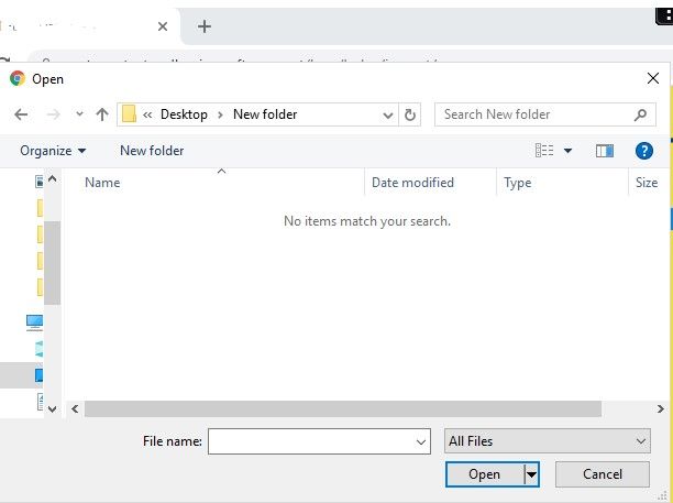

I am having trouble attaching to a “Open” Window from Google Chrome while headless. It is a window that pops up from the website to browses for a file… Works just fine when I am watching…. Example of the window below:

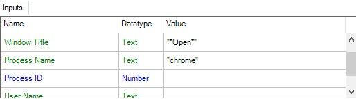

The attach stage is:

I was able to spy this window using IE but you have to create a separate object. But for some reason using the chrome I was not able to spy the Open File Explorer Window even after creating the new object to attach. Please post if you find the solution using the Chrome.

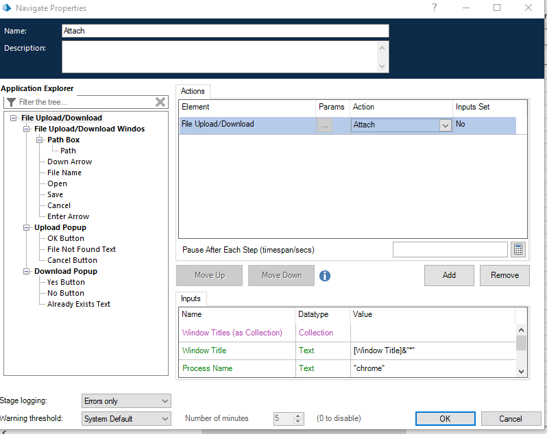

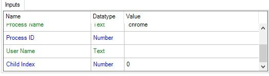

I have found a way to spy the Open File Browser window in Google Chrome. If you are using virtual machine for the spying, please do not use control room and debug mode at the same instance. When you use Control room do not debug and vice versa. I have attached the screenshot for Attach Screen and Application model.

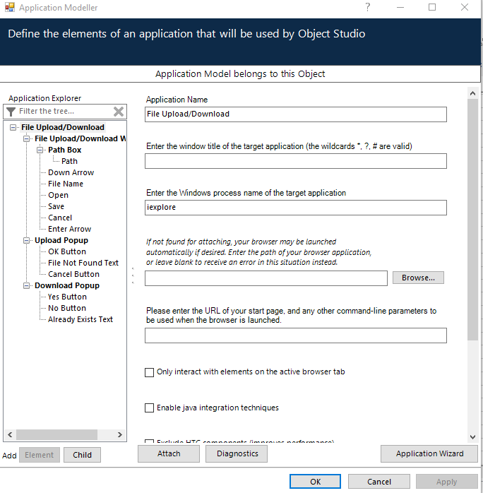

@Kaylem Attwood I have sent you the details on your message, in addition to that here is the screenshot of the attach stage, Plus the application modeler that I have used. When I initially created the app model I used IE, but you can still attach it to the chrome window with the following attach stage.
