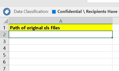

Here is the macro which you may want to use for converting the xls to xlsx . Once done, you can easily open and do whatever you want on your xlsx file 🙂
Hope it helps.
Steps:
1- Create an instance, open the converter.xlsm, Write the name of xls file in A2 of this converter of xlsm file attached.
31278.png2-  Once done, us e the run macro action to run the macro named "ConvertToXLS"
3- It will save the file in xlsx format for you to use further.
