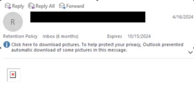

But we are receiving message as red cross mark image in the email body.
Please find attachments below for your reference:
Please assist me to solve this issue, Thanks.

Just remember that when using HTML and calling images, they need to be available on the Internet; if they are on the local machine or intranet, you will keep having that issue.
Thankyou @expertcr
Is there any alternative solution to achieve and to overcome this issue.

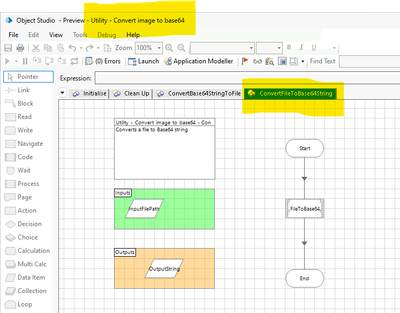

Hi @Ginukuntla,
Use this VBO to convert the image itself to base64: Output -> [imageBase64]
You can find it on Digital Exchange.
After that just add the following code to the HTML email message:
I hope this helps.

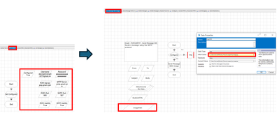

Hi @Ginukuntla,
You can send the images as part of the email body by following the below steps:

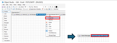

  • Open the SMTP/POP3 business object and make a copy of the action - 'Send Email' and you can name it as 'Send Email With Image' as shown below:
  • Now, add a data item called 'ImagePath' of text type and add it as an input argument to your code stage as well:
  • Now, in the code tab enter the following code:

To summarize the change, we are creating an alternate view that will comprise of our image as part of the HTML content of the email body.
  • Now, you can pass the configuration parameters for your SMTP call and set IsHTMLBody parameter as 'True' and pass the image file path as well:
  • First, run the 'Configure' page and then run the 'Send Email With Image' page to test it from the object studio itself:
  • Now, when you have tested the action, ensure you add the ImagePath variable as an Input Parameter in the Start stage, reset or clear all the initial values from your data items in both 'Configure' and 'Send Email With Image' page and finally publish the action 'Send Email With Image' prior to saving the business object and testing the same from Process Studio.

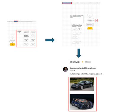

Hi @devneetmohanty07
Is it possible to send multiple images in body of the mail. If Possible, please assist me.
For Example, if we have three images in our folder, after sending mail I want to see three images in body of that mail.
Thanks in advance.
Hi @rokkam_saiteja ,
Certainly, if your requirement is to send multiple images as part of the email body itself, I would advise to follow the same approach with I have suggested in the previous replies with certain tweaks:

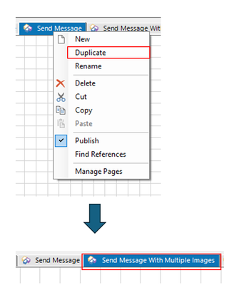

  • Open the SMTP/POP3 business object and make a copy of the action - 'Send Email' and you can name it as 'Send Email With Multiple Images' as shown below:

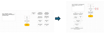

  • Now, add a collection called 'ImagePaths' with a field value called 'ImagePath' of text type and add it as an input argument to your code stage as well:

Main difference in this code is that, instead of one image path we are iterating over the collection of image paths and setting up an array of LinkedResource objects based on the number of image paths provided.
Then, each of these objects have a contentId which is getting appended to an HTML string with an adjustable width so that they do not span all across the email body.
Finally, we create an alternate view out of these HTML strings and then the LinkedResource objects are also added to the alternate view as well.

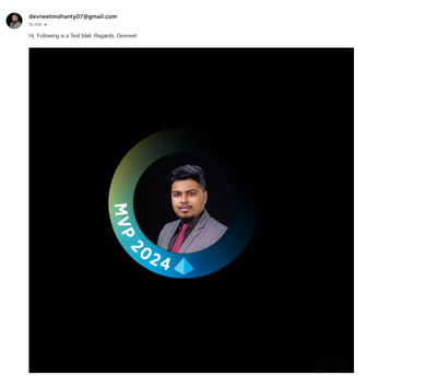

  •  Now, you can pass the configuration parameters for your SMTP call and set IsHTMLBody parameter as 'True' and pass the image file paths as part of the collection:
  • First, run the 'Configure' page and then run the 'Send Email With Multiple Images' page to test it from the object studio itself:

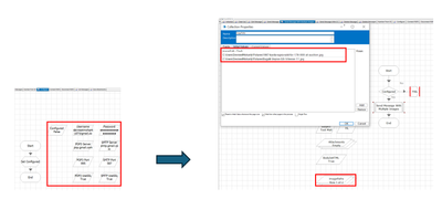

  • Now, when you have tested the action, ensure you add the ImagePaths collection as an Input Parameter in the Start stage, reset or clear all the initial values from your data items in both 'Configure' and 'Send Email With Multiple Images' page and finally publish the action 'Send Email With Multiple Images' prior to saving the business object and testing the same from Process Studio.
    From process studio, just ensure you have a collection with all your image paths saved in individual rows with the field name set as 'ImagePath' and you can pass that to your newly created action now.
