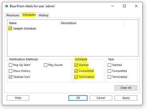

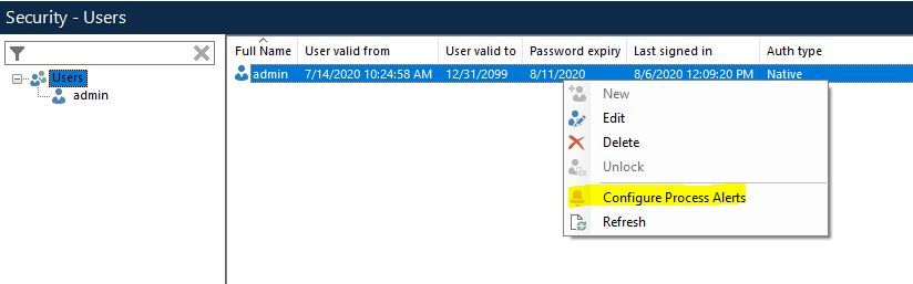

Hi Prem,
/alerts should work but you need to have schedule alerts configured.
To do this, go to System -> Security -> Users
Right click on the current user and select Configure Process Alerts. This opens a Blue Prism Alerts for the user, where there is a tab for Schedules where you can choose which schedules you want alerts for and what types of alerts you want.
Alert types for schedule are Started, Completed, and Terminated. Screenshots attached. Let me know if that works!
