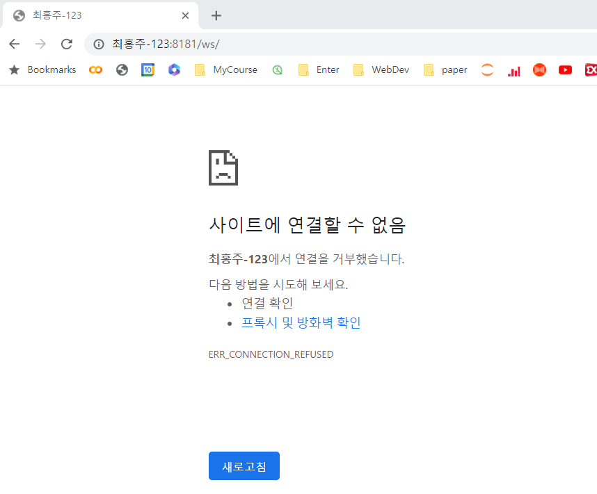

If you're testing this locally on your machine and you go to http://127.0.0.1:8181/ws/ and you're getting a connection refused then you either:
- Don't have an actual Blue Prism runtime resource instance running
- You do in fact have some sort of firewall running which is intercepting the request.
- Your runtime resource is configured to require HTTPs

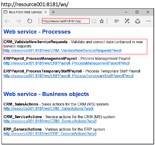

We found the Process Dispatch Framework from the DX, which looks like fulfilling the dispatcher functions based on SOAP communication between Blue Prism and external entities. One of the preliminary settings in order to use this asset is to expose the existing process (to be trigged by 3rd-party entity) as a web service.
After having configured the process exposure from the system tab, the web page (http://[machinename]:<port>/ws/.) seems to be supposed to appear as below according to the manual but in my case, error message showed up saying "Access denied". I'm testing this in my own laptop and there's no firewall settings.
Can you help out? Did I miss something?

From what I can see of the error screen, it looks like you're navigating to a different machine than what the first browser screen shows. Do you have two different NICs or different machine names?
10-01-23 02:24 AM
This test is being done on the same machine, where Blue Prism v7.1.1 is installed.
"최홍주-123" is my hostname and I've got the same error with "http://localhost:8181/ws/" as well.

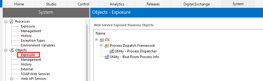

1) Following the Web Service User Guide, the Exposure settings in the system tab has been done.
2) But, I couldn't find any WSDL file generated anywhere in my laptop as a result of this setting.
The SOAP Web Services setting is also empty.
3) When attempted to set this SOAP Web Services by manual, there came up the error message perhaps due to the absence of WSDL.
