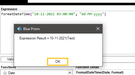

EmersonF
I believe you can use this function FormatDateTime ([Hora Local], "dd-MM-yyyy"), I believe that will work!!

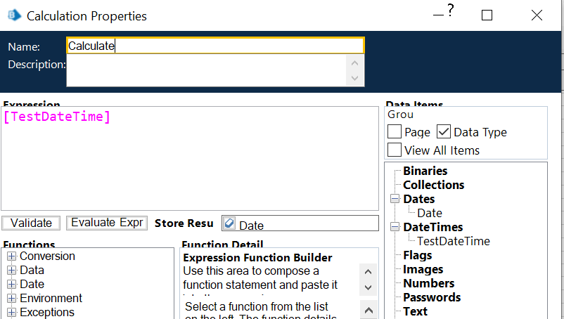

ritansh.jatwani
Level 9
Hi @NehaGote,
As mentioned by @EmersonF, it is one of the ways to convert the datetime format to date format. Also, you can use casting feature of Blueprism where store the input datetime in a variable and then using calculation stage, just store that output value in a date variable type. PFB the screenshot for the same:

Hi Emerson it worked thanks 🙂

Hi Ritansh , Thats a cool feature I agree with Emerson never used it before. It worked thanks 🙂
