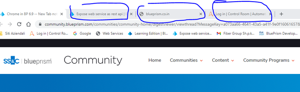

I am facing problems while spying a new tab .I tried all the type of spying but nothing has solved my problem .
Can someone help me that?

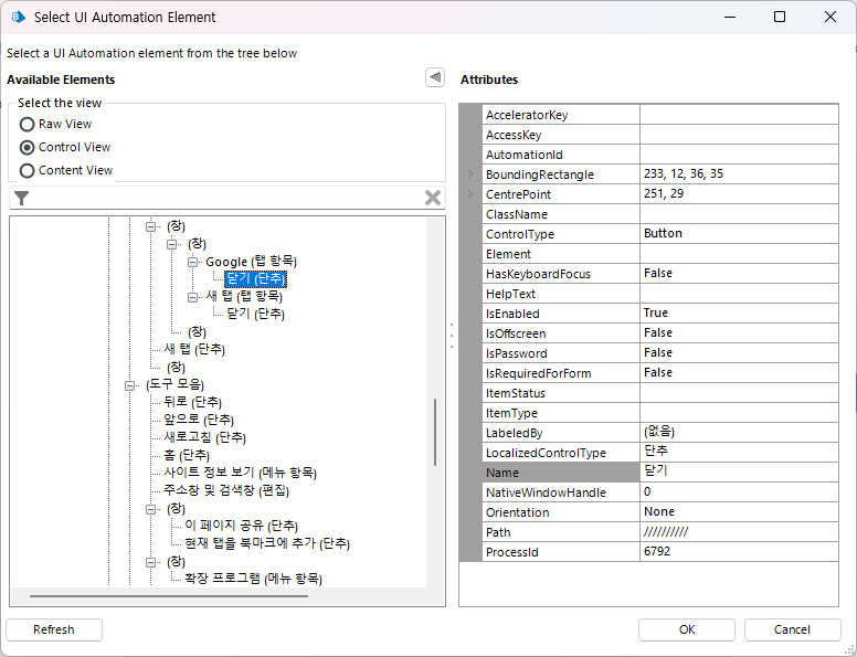

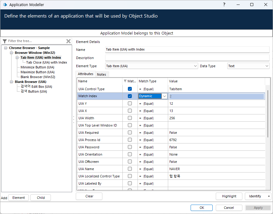

In Application Modeller Window, choose Open UI Automation Navigator instead of Indentify button.
Then, you will find Tabitem Elements for the Browser.
Selecting Match Type of Match Index as Dynamic, you can choose tabs freely as you wish.
Hope this helps you.
