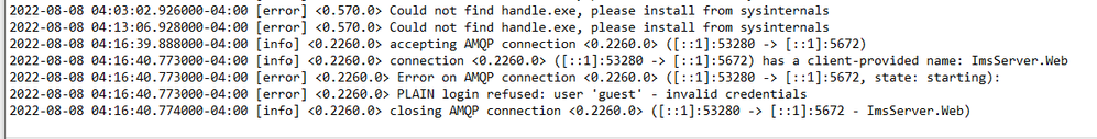

How can I update the RabbitMQ user details now to a new user?
In programs and features, I do not see a program modify option to change this parameter.
Below is my error with RabbitMQ

Hello Tejaskumar, I hope you are doing well.
Depending on how far into your Hub environment you are, it is likely easier to reinstall Hub with the correct RabbitMQ configuration. Changing it requires a lot of manual file editing using the Data Protector tool, downloadable here. So while it is possible to go through and manually decrypt, change, and re-encrypt the files, it would likely be easier to do a reinstall.
I hope this information is helpful!

All the other configuration steps(IIS, Rabbit, AppPool, hosts, certificate, etc) which were done during installation also need to be undone manually by the user end to end to completely uninstall the hub !

There is no repair option with Hub in programs,
And I thought about the re-running Hub installer but was not sure if that is the right way because the guide states you need to undo all components step by step before doing a reinstall.

shift and right click in BluePrismHub-4.6.msi file will give you option for repair. If no luck, uninstall and install also will not take much time and will overwrite existing db and existing setting of HUB.
