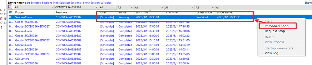

I can not stop warning session
nothingbigger01
i can not stop this session, and i already reboot blueprism,Still ineffective.
If the process cannot be stopped, subsequent processes cannot run

As per my Knowledge Warning sessions can't be stopped from the user side, you need to figure out why the system went to warning state by logging in to the System from your side .There might be some unwanted Pop up's are blocking the processes to proceed further and close the pop up's if any present in the ongoing process. Once the Pop Up's are closed then warning stage will be disappeared and will back to running state.
Recommended to Signoff the System and re-login to start the schedule again.

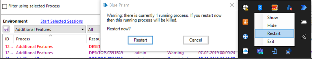

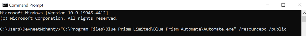

Alternatively, you can locate the Runtime Resource agent from the system tray. Right click on the agent icon, select Restart option and it should show a pop-up asking for restart confirmation as a process is running, click on Restart and then you can turn on the Runtime Resource agent using the cmd command:
"C:\Program Files\Blue Prism Limited\Blue Prism Automate\Automate.exe" /resourcepc /public
