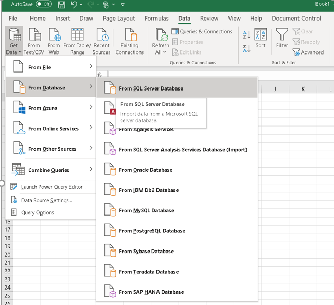

Hello Camilla,
As per my understanding.
You are trying to load excel table into database. In that case excel provides an opportunity for us to connect excel and SQL server (refer screenshot).
Further reading: https://www.mssqltips.com/sqlservertip/1430/import-excel-data-into-sql-server-using-copy-and-paste/
And if you are trying to connect a database table with Blue Prism, then there exists a VBO - "BPA Object - Data - SQL Server".
You can find the same inside the folder : "VBO" inside the "Blue Prism Automate Folder".
It can very easily be imported this VBO into Blue Prism.
Using the action "Set connection" -- requires relevant fields as input (Server instance name, name of the database, userID, password) to complete the connection.

13-01-21 03:55 PM
Hello Camilla,
Anuraag

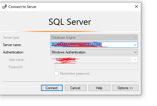

13-01-21 04:17 PM
i've imported the BPA Object - Data - SQL Server.
database,
userID,
password
I've used
Server name from SQL Server Managment Studio, Database Name created, User with domain, Password
It doesn't work.
CAmilla.
14-01-21 08:44 AM
The image is not very clear.
But, there are few things you can check from your side.
1. Is the SQL Server already configured? You can search for "SQL Server Configuration Manager" in your system to verify this.
2. If point 1 is a yes, then is your Use case is testing / research purpose? If you are using the Express edition of the SQL Server, in that case you probably do not have
a additional security set.
Further reading: https://serverspace.io/support/help/install-and-configure-ms-sql-server-express/
3. Is Blue Prism already up and running, with a configured database? if yes.
Example
Business Object:: Data SQL Server
Action:: Set connection
Inputs:
ServerName:: "localhost/SQLExpress"
Database:: "<database name>" (As configured previously)
User:: <credentials same as SQL Server>
Password:: <credentials same as SQL Server>
You can also share the error message if you see one.
Anuraag
14-01-21 01:29 PM
I've configured the SQl Server wih SQL identification and it seems working.

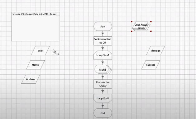

19-01-21 07:34 PM
There can be several ways to approach this.
My suggestion would be.
Manually create a new database table to match your requirement, primary key defined, and datatype + plus assigned to each of the fields.
1. In page 1 - fetch values from excel and extract all information inside a collection stage
2. In page 2 -
Step A: START STAGE : here you can fetch the collection from previous page (this is a design choice, you can transfer data from one page to another the way you prefer)
Step B: ACTION STAGE : Data SQL server - set connection; here you can set connection with your database
Step C: ACTION STAGE : Data SQL server - Execute,
INPUT : here you can use an INSERT statement, the table (previously created) along with the fields (values will be fetched in a loop from the collection and written inside data items which will then be picked by the query)
Example:
"INSERT INTO <TABLE NAME> VALUES ('"&[itemID]&"', '"&[UserName]&"')"
OUTPUT: here you can fetch success message, just to be sure that the process worked, or capture the error.Regards,
Anuraag
20-01-21 08:09 AM
Now It seems working.
In case of problems can I write to you?
cami
