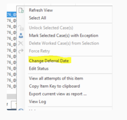

Hi @Mukesh Kumar ,
Thanks for your response, but like mentioned above I want to know whether we are able to achieve the below functionality of changing the deferral date s through Control Room UI using any VBO:
please o let me know in case you find something more over the same

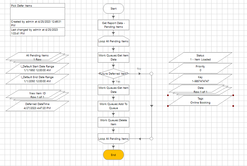

25-04-23 05:55 PM
Based on the scenario you described, it appears that there is no direct method to change the defer time of an item without locking it. However, an alternative approach could involve modifying the design of the system to use tags and priority for item locking instead of relying on deferral.
However, this approach may not always be feasible, especially if the project is already in the testing, user acceptance testing, or production phase. In such cases, a possible alternative solution could be as below:
Use the "Get Report Data" action to retrieve all pending items
Use a loop on these pending Item IDs
Check if the item has a future defer time. If it does, proceed with the following steps. If not, skip to the next item.
Retrieve the item data using the item ID.
Create a new work queue item using the same data as the original item but with a past deferral time.
Delete the original item that was future deferred.
You now have a new work queue item with a past defer time that can be picked up by downstream processes as a replica of the original item.
This process allows you to change the defer time of an item without locking it, but only for items with a future defer time. It may involve some additional steps but achieves the purpose with a tradeoff on the Creation Date field in the control room.
Attaching a studio snapshot here for your reference.
Let us know if this helps.
