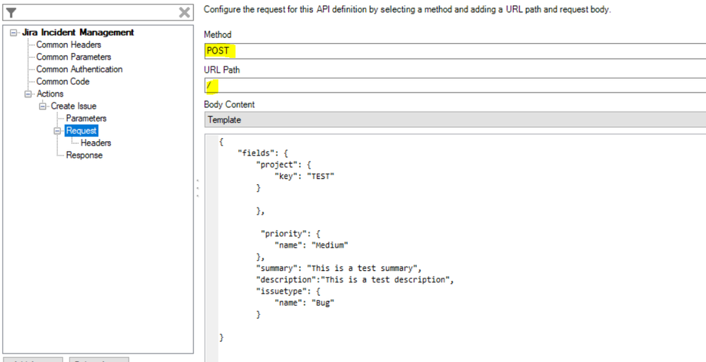

I am trying to create a new JIRA ticket using the rest API in BLUE PRISM, and I am using the below configuration as per the screenshot.

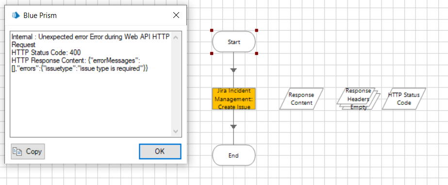

But I am getting below error as mentioned in the below screenshot.
Could you please help me understand where is the issue?

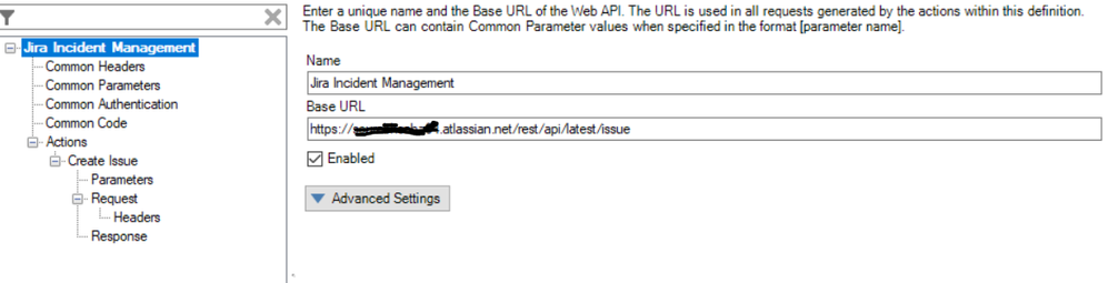

I am using my free Jira version  and the "End Point URL" in the below format:

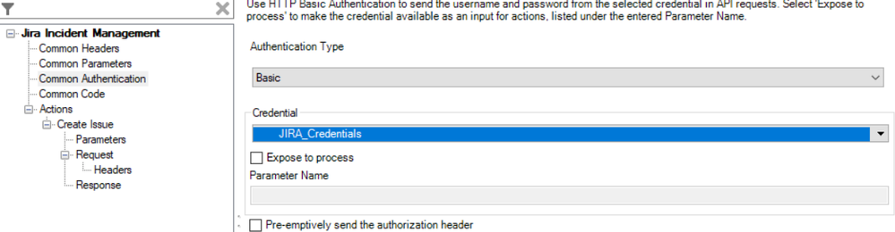

For BASIC Authentication:  I am using the Email ID and password that I used to create the free JIRA account:
I am using the request body to create a new issue as below:

Hi @SourabhSaha,
​From the example in the Jira REST API documentation, they specify id as opposed to name for the issuetype. You might give that a try.
