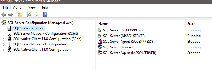

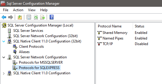

I too was facing the same error but on the enterprise version.
In my case, the SQL Express service was not running due to port conflict.
Check that your server is up and running. For this open SQL Server Configuration Manager and make sure that your server is running.
If the server is not running then it will keep throwing this error because blue prism is not able to locate the database and connect to it.
Also, you can try disabling TCP/IP and see if that service starts running.
This solution worked for me so I'm dropping down the solution here in case this helps in the future.
