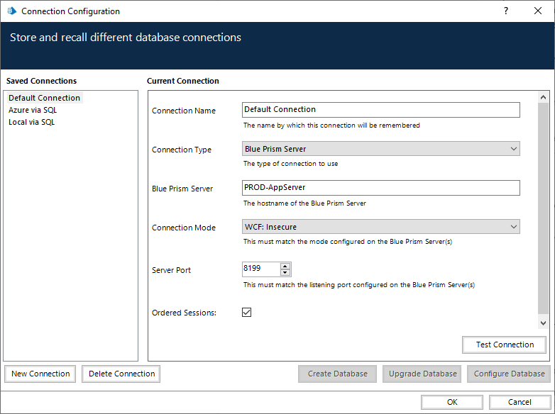

As requested, below are various screenshots of my Interactive Client's "Configure Connection" screen.
This is the connection to the BP App Server running on an Azure instance.
I've got WCF: Insecure configured because I don't have any Active Directory, etc., setup in my environment. It's a demo environment only.

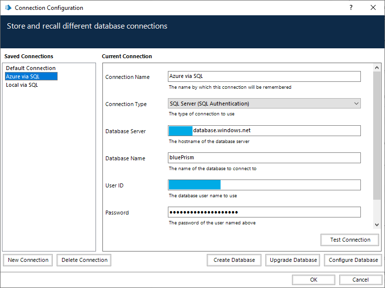

And this one is for when I bypass the BP App Server (so I don't have to spin up the Azure instance and incur additional costs) and instead connect directly to my Azure SQL database.
One more thing Reny. Your error message often indicates that the BP App Server and the Interactive Client are configured with different connection modes. Maybe your App Server is configured for WCF: Message Encryption while your IC is configured for WCF: Transport Encryption. You have to make sure they both match.
Maybe try with WCF:Insecure in the first instance to rule out other connectivity problems then if that works switch over to one of the encrypted methods.
