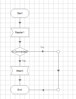

May I ask, what do you mean when you say include the bring-to-foreground action in your Attach action. - What step do I have to add? Can you please clarify? Thank you!
Here's my attach page and steps

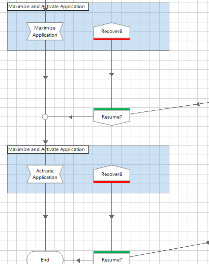

Below is the screenshot for Recovery and Resume stage added at the end of the Attach page.

Attach page screenshot

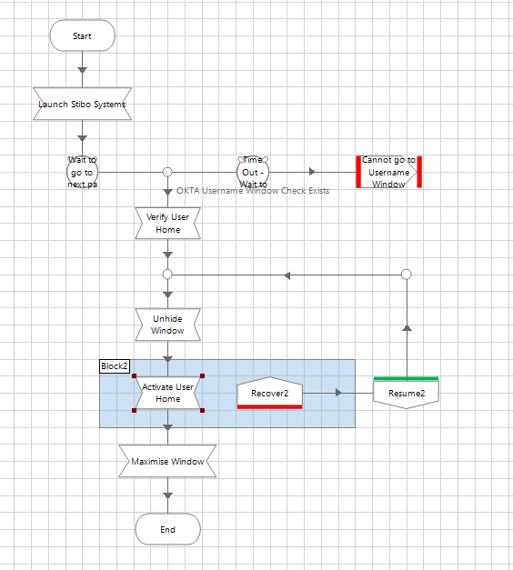

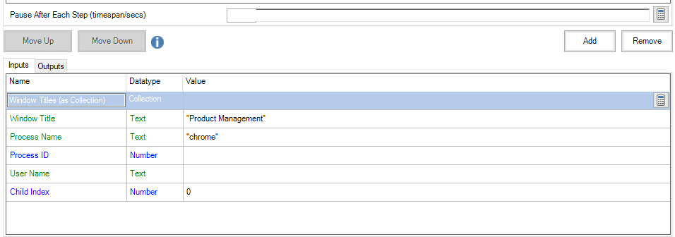

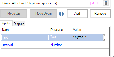

Here are my steps:
In the unhide window step, I put:

Hi Babjee,
I have tried your suggestions but seem like it's not working tho.
