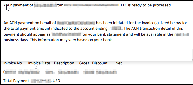

I need to save the text of an email as a pdf for backup. This includes lines of text, and a data table.  I am using List Mail in Folder and Get Mail.  The HTML body is helpful for processing the data tables, but there does not seem to be a place where the email is read with spacing intact that I can use to make a .pdf.
##Sample Expected Output:
I attempted to follow steps from the link below but creating the code step resulted in a compile error, and the Regex Replace did not retain the padding/spacing that the email would have created (the table ends up becoming an unreadable string).  I attempted the 'Save as file' but this converted to an .eml file.  Is there a way I can get from the 'Get email' to the outputted pdf of what the email looked like?
