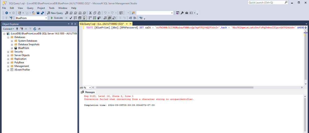

Good morning. I tried this solution to reset my admin password and unfortunately it did not work for me and I received the attached error message. I am working on V7.3.0 and any help is much appreciated. Thank you in advance
10-09-24 10:17 AM
The query above is incorrect - the BPAPassword.userid column cannot be 'admin'. Suggest you raise a ticket with BP Support to ask them for the reset script for your version of BP.
