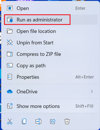

When you test this in Blue Prism, are you doing so from the Interactive Client (i.e. debug mode) or actually running it on a resource via Control Room? If you haven't tried running it in debug mode, could you do that? When you do, I'd like you to start the Interactive Client using the admin account. Simply right-click on the Blue Prism startup icon and select Run as administrator from the context menu. After that, try stepping through your process in debug.
