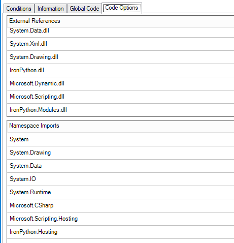

I have a use case where I need to excecute a python script.
My question is if you need to have python onboarded or IronPython as this example uses:
Code Stages (higherlogicdownload.s3-external-1.amazonaws.com)
var py = Python.CreateEngine();
string scriptpath = @"pathwaytoscript.py";
if (File.Exists(scriptpath))
		py.ExecuteFile(scriptpath);
The error I'm getting when trying to run the action:
ERROR: Internal : Could not execute code stage because exception thrown by code stage: Could not load file or assembly 'IronPython, Version=2.7.11.0, Culture=neutral, PublicKeyToken=7f709c5b713576e1' or one of its dependencies. The system cannot find the file specified.
Is it required to have Python installed/onboarded to the VM?
The IronPython DLL is placed in Blue Prism install folder

@Johan Sörman,
This type of error can be a real pain to troubleshoot. Sometimes, the issue is the specific DLL mentioned in the error message. Other times, the error is related to a DLL that top-level DLL depends on. So, troubleshooting this can become a bit of a rabbit hole.
You show that the IronPython.dll library is listed in your references, and you stated that you have deployed it within the Blue Prism Automate folder on your machine. Did you just copy the DLLs from another machine or did you actually install IronPython on the machine? If you just copied the DLLs from another machine I'd say you probably want to try actually installing IronPython on it.
If that doesn't address the issue, then it's likely that you're missing a dependent DLL. To troubleshoot that you'll probably need to grab a copy of the Dependency Walker utility in order to see what other files are being referenced.
