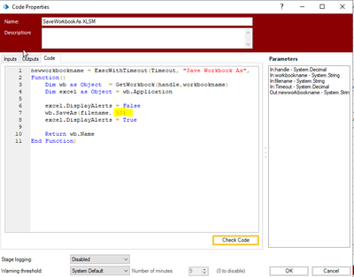

21-10-24 01:23 PM
Hi Eric,
I need to save my excel csv file as an xlsm file, as i need to use the oldeb actions.
i checked out the link you sent for excel supported formats and xlsm = 52
i have made a duplicate of the "save workbook as" action in excel vbo and input 52 into the code as you suggested above - see below code
but I'm getting this error when running the action? is my code wrong or do you have any ideas why its not working?
Frankie

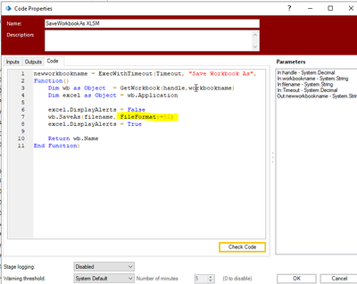

21-10-24 01:30 PM
sorry just to add i did see a save workbook as xlsm action under the MS Excel Extended vbo - ErnstYoung - so checked the code out on that and could see it was set as FileFormat:=52
I did update the cod eon the one i have created but still get the same error
21-10-24 02:33 PM
Hi @FrankieTEWV
Bit of an odd error there. Not sure if it's saying there's an issue in the workbook or within the VBO trying to locate the instance. In your process are you creating a new instance of Excel or are you attaching to an existing instance?
Eric
