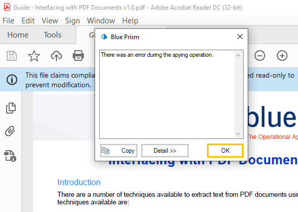

I am working with a report that will export details only in .pdf format, I able able to start the application modeler to launch it, but I am able to spy it only with the UI option but It is not working
as I tried with the others as per some youtube example, and I am getting this error
There was an error during the spying operation.
System.InvalidOperationException: The window spied was not found in the model
at BluePrism.AMI.clsAMI.Spy(clsElementTypeInfo& elementType, List`1& identifiers)
at AutomateUI.frmIntegrationAssistant.HandleSpyOrLaunchClick(Object sender, EventArgs e)
would you have directions what happens and how can bypass this, or can you provide details of other available actions for pdf, I was also looking at the Utility - pdf, and seems is not available for downloading in blueprism, but under a different location and quite expensive also..
thank you for your help

​ok, but would you know why I am getting this error when trying to spy directly to the PDF adbobe?

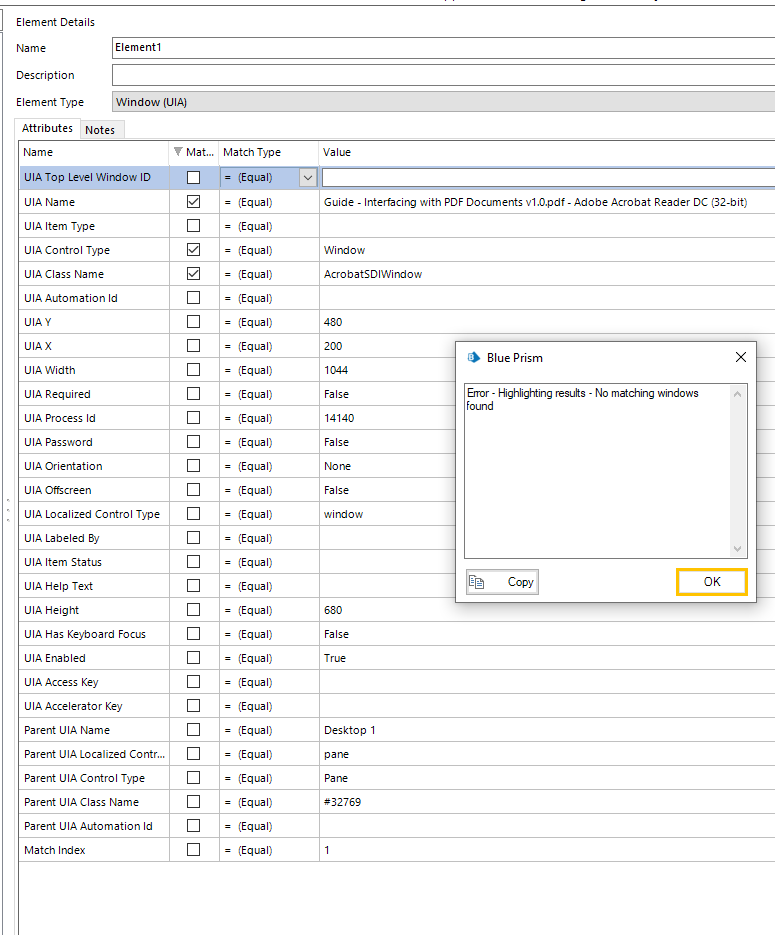

Thank you @GuggsKia​I found this earlier, but same issue but I am looking at .pdf file
there is a lot of questions in blueprism forum, and seems is not going to be easy! as @EmersonF, mentioned I could try with Decipher, and I am going to give it a try..
the only thing I need to find out how to spy it.. I also found a you tube video to show about spy pdf, but I think there is something not working with rpa !
I wonder if you have tried to do a test to spy pdf with w32 instead of UI tool and if you tried with UI tool what attributes you are leaving checked and does it work?
