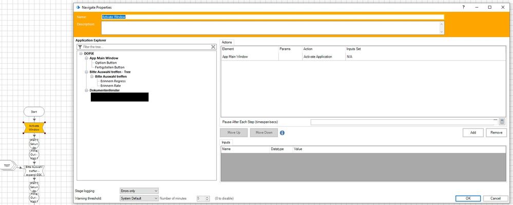

Error Message:
Internal : Failed to perform step 1 in Navigate Stage 'Activate Window' on page 'DOPiX Prozess - Send Keys' - Unable to match any windows with the query terms

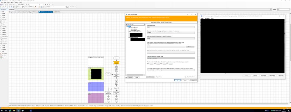

Description:
I exported a release from the test environment including all necessary components and imported it into the production environment. No changes were made to the process or object after importing the release.
Issues Encountered:
  • When debugging in the production environment, the above error message is encountered.

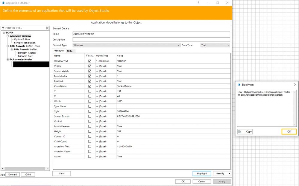

  • When opening the Application Modeller in the production environment and clicking "Highlight," I receive the following error:
    Error - Highlighting results - Unable to match any windows with the query terms

david.l.morris
Level 15
2nd Edit: I see you found the solution while I was typing this message. 😃
It looks like you (or someone) is able to debug in Production. If that is the case, did you try creating a new element temporarily and spying/identifying the same App Main Window and then compare what the attribute values are? It could be something as simple as a tiny difference in spelling in the class name or window text.
Just to mention, glancing at your screenshots, I would agree that it shouldn't have this issue, so that is odd. But the first thing I'd verify is to see what Blue Prism finds as the attribute values for the main window in Production. It could just be something you couldn't have predicted.
