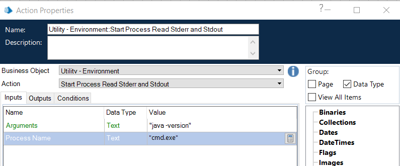

07-06-20 02:28 AM
Hi Gopal, Just to add I was tried below to run a command on CMD and capture output but this doesn't work and my process stops responding. Eventually my aim is once this works, i want to invoke a java class with cmd and wait for its execution to finish and capture the output from cmd.
Mayank Goyal

07-06-20 09:40 AM
Hi Gopal, I was able to fix the BAT file execution by passing path of .bat file in process name and putting my java command to execute in .bat file. It is also waiting for java program to complete and captured output from CMD screen.
However, I am still not able to figure out if I have to pass command directly on CMD without using .bat file, how will I use this action in that case?
