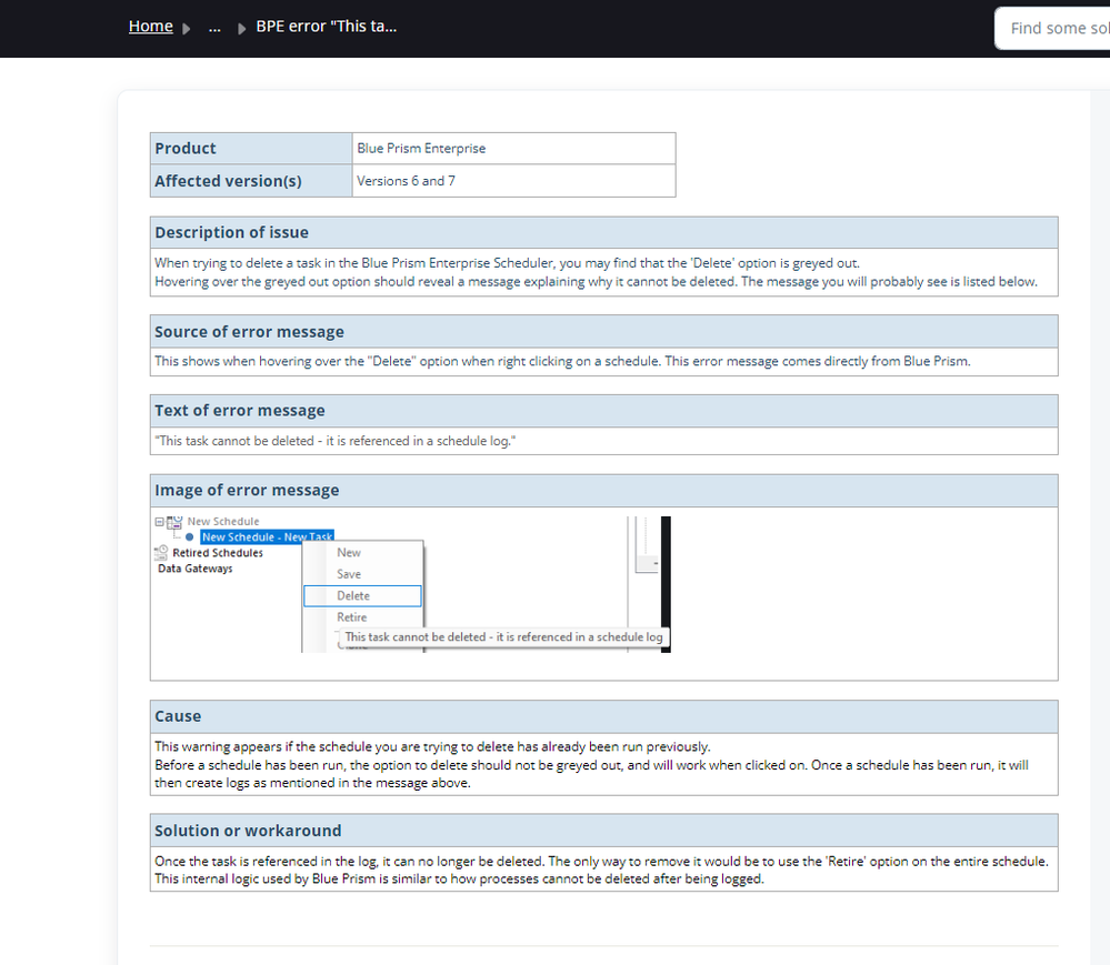

I think there is no option to delete the task in a schedule. please see the link below for your reference.
BPE error "This task cannot be deleted - it is referenced in a schedule log." and 'Delete' option grayed out when trying to delete a task in Scheduler : (blueprism.com)

Thanks for the direct link to the resource. We already tested the solution mentioned in the article so I created a new test scheduler without any process/session/bot still the option to delete a task is greyed out. When a new scheduler is created and it is never run before so there must be no entry in the logs but still the option is greyed out.
