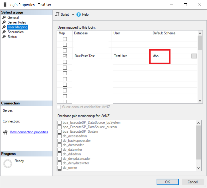

If you look at the SQL scripts used by Blue Prism to upgrade the database closely, you can find that various schema objects are not prefixed with database schema name.
This essentially means the script will be run against the default schema of the database user. I think in your case, your default schema is not set to dbo hence the behavior you have noticed. See below screenshots on a Blue Prism database I have for TestUser.
Please also refer to this third-party discussion post to find ways to get around this.
