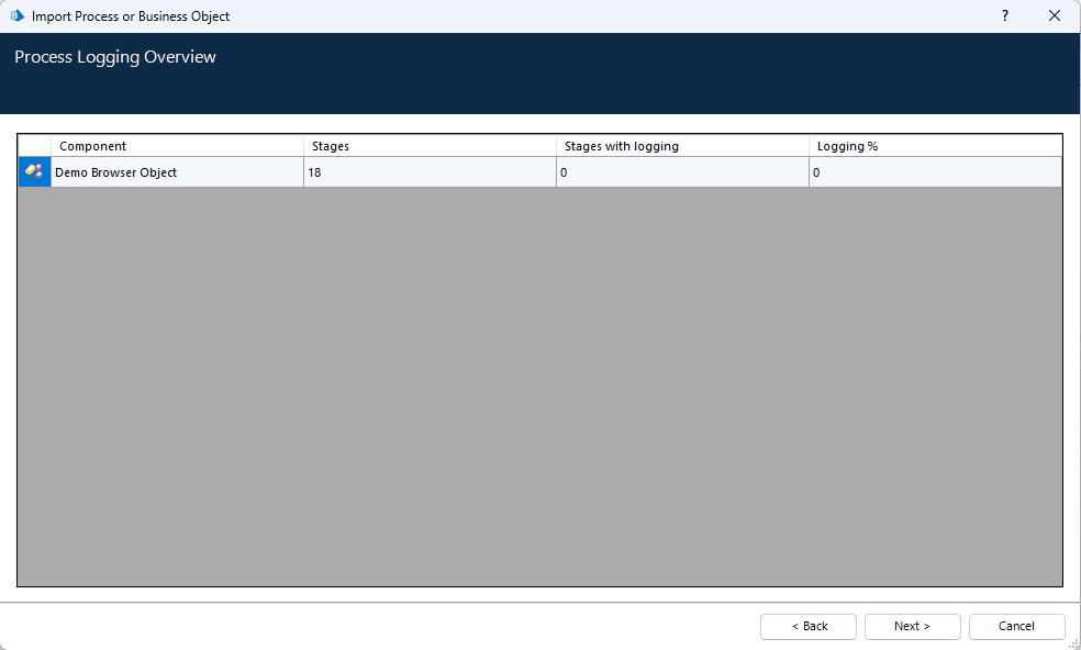

When we import release packages today, we see the following:
  • Process or Object name / number of stages in the imported process or object / Number of stages with logging set to "Enabled" / Percentage of stages this represents

To your final point, "Additionally, setting the logging parameters to "errors only" causes them to be included in the logging enabled parameter, reducing the overall usefulness of the logging enabled function" - when I test the logging overview capability in BPE 7.3.1 (the latest release), any stage that has stage logging set to anything other than "Enabled" does not show on the stage logging overview that is provided. If I have 100 stages in my process or object and they're all set to "Errors Only", then my report in BPE 7.3.1 shows that I have 0 stages with logging and 0% in the logging percentage. Are you seeing something different and, if so, can I ask which version your release package was created with and what version of Blue Prism Enterprise you are importing the release into?

Hi @rvaneupen,
The logging report shown on import has, from my understanding, not changed significantly since it's introduction, so the capabilities you see in v6.10.5 are likely the same as what we see currently in more recent versions.
However, on the point of errors only logging counting towards statistics, I'm unable to see this despite trying with several variations of file (processes, objects, releases or single .xml/files) in various scenarios (importing new files or overriding existing files) regardless of version used (I've tried v6.10.5 and v7.3.1).
Import of a file containing errors only loggingImport of a file containing errors only logging
Would you be able to either open a support ticket to report this issue or share a file in which you see this happening with me directly? If going direct, please feel free to reach out by private message on the community.
