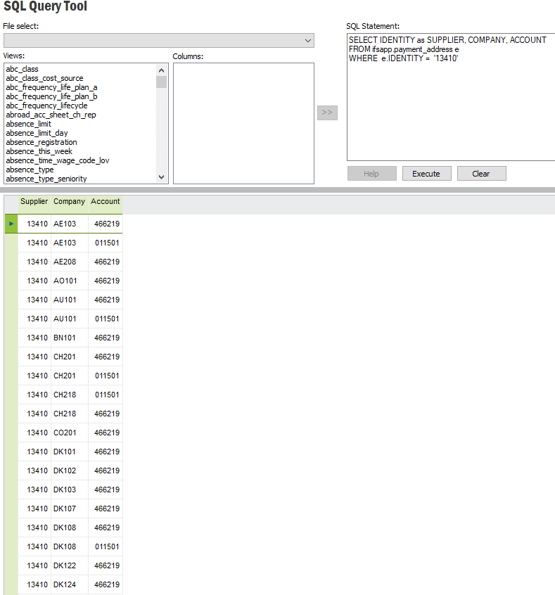

I have added 3 validation lists in my DFD - SupplierList, CompanyList, and Account List
What I wanted to do is to show only Account Numbers based from the value of the Supplier and Company.
(e.g If I choose 13410 supplier and AU101 company, the dropdown list for Account number should only show 466219 and 011501.)
How do I do this?

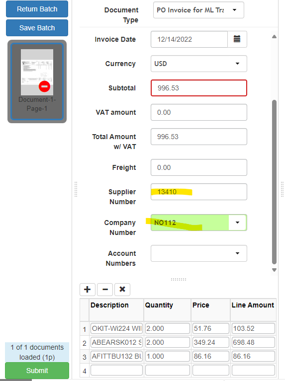

I've been using the SQLEXEC and STRJOIN commands as well and found some samples here Import settings (blueprism.com). Also, I have updated the Flags to AutoCalculate and DynamicList.
I used the formula you gave, updated the column ID names, so here's the updated SQL:
SQLEXEC (STRJOIN ("SELECT COMPANY FROM BI_PAYMENT_ADDRESS WHERE SUPPLIER = '", Supplier_No, "'"))
However, it is always showing one value for the Company. In the sample picture, it's always NO112. The dropdown list doesn't even show any options to choose from.
For the Account Number field, i'm using this formula but it's not showing anything from the dropdown list.
SQLEXEC (STRJOIN ("SELECT ACCOUNT FROM BI_PAYMENT_ADDRESS WHERE COMPANY= '", Company_No, "' AND SUPPLIER = '", Supplier_No, "'" ))
Did I miss anything? I really appreciate your help.

The idea behind the validation list is that Decipher reads the value from the PDF and does a look up to confirm it exists. -> Some of the fields may not be in the PDF file, like Suppplier Number for example(some Invoices has Supplier number, others dont), that's why I did NOT choose the Assignable field, but it's a Required field.
Do you want the values to be in a list? - > Yes, I want it to be in a DynamicList, whereas the list changes depending on the SQL. Isn't that what DynamicList is for?
Do you want to validate the values against the validation list? -> Yes.
So is Decipher finding the value NO112 on the PDF? There should be no reason for Decipher to pull this value out of midair so it must be coming from somewhere? -> The NO112 is not in the PDF. It's coming from the validation list but it's not showing all possible value based from the SQL.
