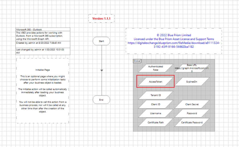

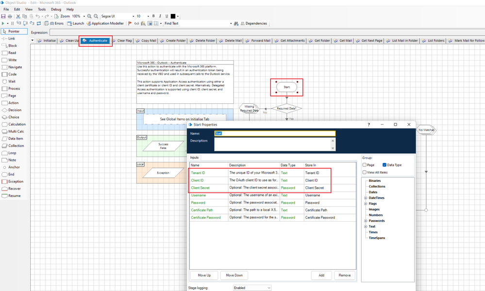

​I don't think you understand how this VBO works. Tenant/Client ID/Client Secret are accepted as input to the Authenticate action. They are not hardcoded. Refer to the screenshots below. Further, we are not calling the authentication action as part of every other action. We check a global Flag parameter named Authenticated on each action. As long as that flag is True, there's no need to go through the authentication process. If that flag is False, then the Authenticate action is called internally.
Further, the Access Token, from a successful authentication, is persisted in a global variable named AccessToken which can be found on the Initialise tab.
Are you sure you're using the latest version of the VBO available from the DX and that no one in your organization has perhaps customized it or inadvertently saved their local changes?

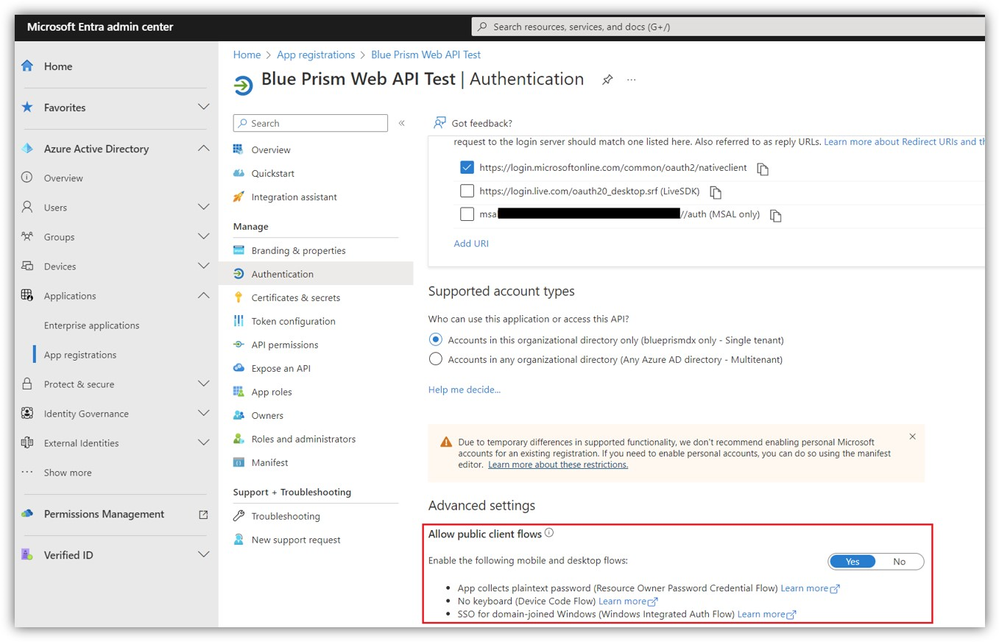

If you're trying to get a Delegated Access token you must pass in the Tenant ID, Client ID, Username, and Password. Do not pass in Client Secret because that automatically results in trying to get an Application Access token. The Username and Password are for the account your Digital Worker is trying to work on-behalf of. Also, I believe Delegated Access will require that you enable the Allow public client flows option within the Application Registration page for the Client ID you're using.
6870.pngCheers,
