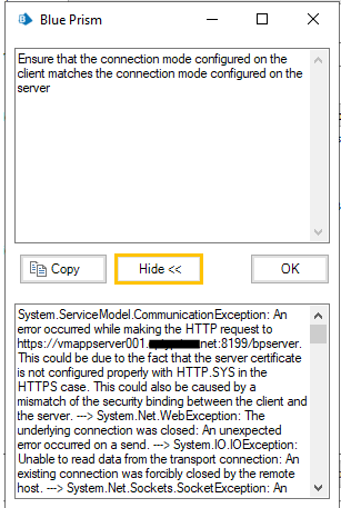

I'm up to page 28 and stuck on testing the server service. When I enter the details (from BPServer) into the configuration window and click Test Connection, I get the following error message:

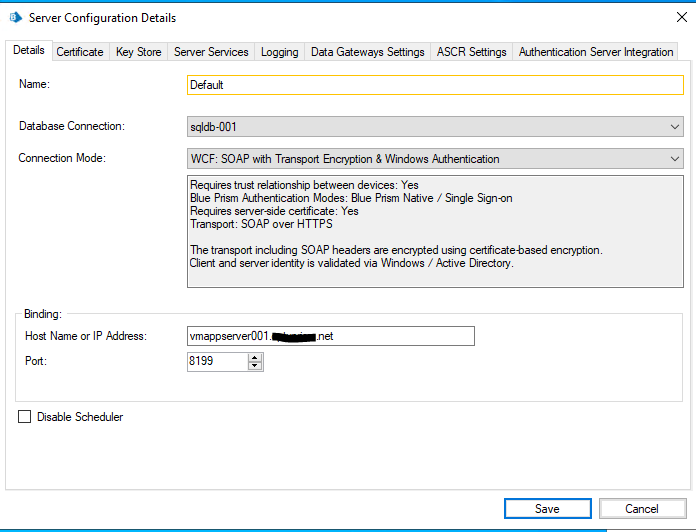

These are my BPServer settings:
And this is what I am entering into the configuration in BP:

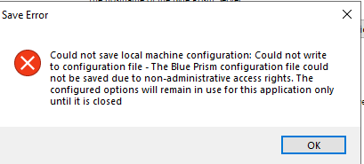

Also, I don't know if it's related but when I try and just ok this screen, to save both Connections, I get an error message saying that I don't have necessary permissions:
I'm logged into the appserver via an RDP connection from a Domain Controller. My ActiveDirectory user has all the same access as an administrator so I'm not sure what else I need to do here.

Hi Michelle - check the config file itself at C:\ProgramData\Blue Prism Limited\Automate V3\Automate.config, see if you have full r/w access to it, and see if the content actually matches what you've set up via the UI. You'll see the config is XML and you can work out which parts correspond to your selections. NB 'automate' was the original name of the BP application - long story.

Just to wrap this up; I did have an Automate V3 folder... I was looking in Program Files not ProgramData.
I did not have read/write access to it and no amount of fiddling would give me permission despite me being setup as an administrator. Alas, I fiddled too much and messed up my windows image so I decided to just delete the VM and start again.
This time the installation went smoothly and I didn't have the permissions error.
I had some further connection issues but with help from BP support we found this was down to certificates and firewalls - or rather a lack of inbound and outbound port access.
