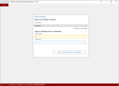

I personally wouldnt use the task scheduler for this and rather embed the listener file in the start up folder so it launches when you sign in. The startup folder is usually something like C:\Users\{username}\AppData\Roaming\Microsoft\Windows\Start Menu\Programs\Startup
In here i would save the listener bat file, as for the issue you mentioned @nazia it looks like you are using sso in the script. Try changing it to be a little simpler using the following script "C:\Program Files\Blue Prism Limited\Blue Prism Automate\Automate.exe" /resourcepc /public /dbconname "PROD ENVIRONMENT"
The dbconname should match however the name is configured in the blueprism application example below. Hope this helps 🙂
