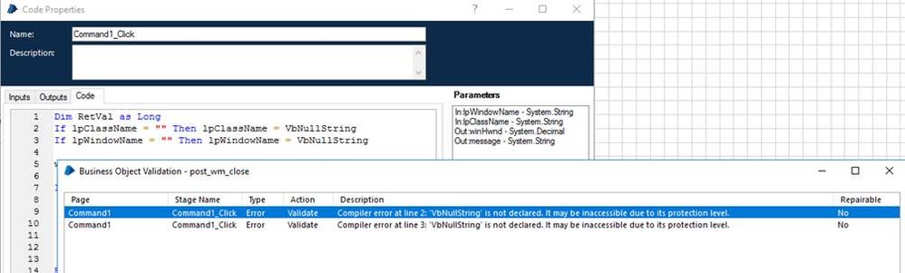

Thanks, Andrey.  Using check code function, system indicate the compiler error as attached screen.

Works for me either way, but you can try replacing VbNullString with Nothing.
Andrey Kudinov
Project Manager
MobileTelesystems PJSC
Europe/Moscow
Many thanks! Andrey. It works after replaced with Nothing.
