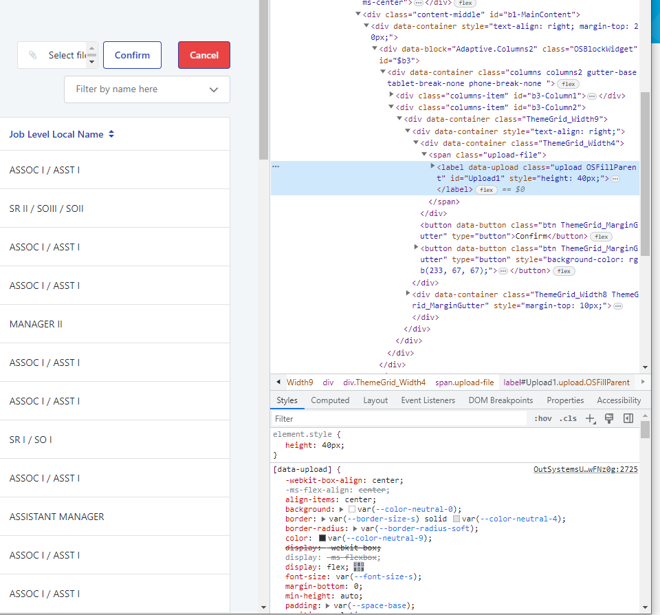

I can locate the element, but when I try to interact with it, nothing happens. The bot can't click the element that I found. How can I solve this issue?30534.png
im refering to the select file

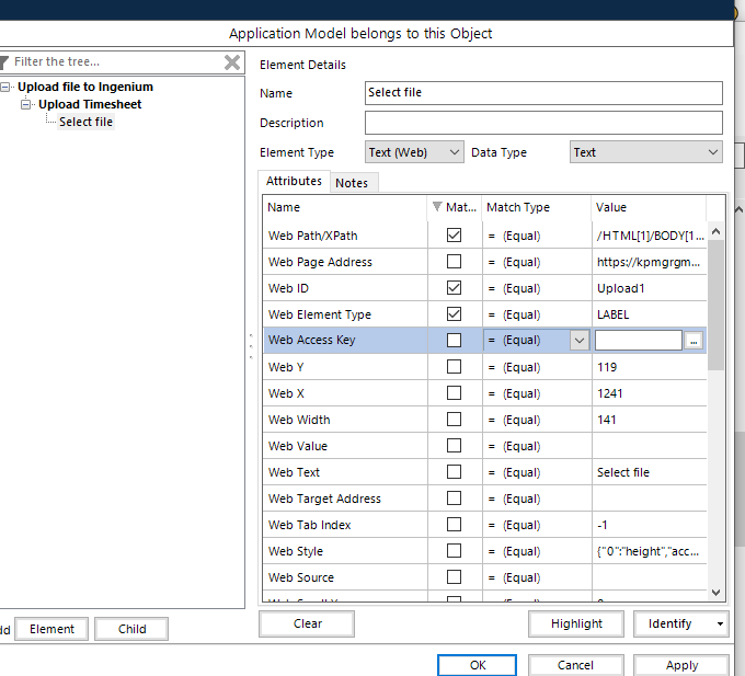

Are you able to highlight using Application Modeller?
WHat are the actions you tried for  interacting the button?
In general you can use navigate stage 1)  focus and Click centre or 2) focus > Global mouse click or 3) Focus > Global send keys and send the enter keyword.
If those actions doesnot work try to spy in different mode and  try similar actions
I usually avoid using webpath/xpath unless it is necessary  if you are planning to use browser mode, try unselecting webpath/xpath and select web text along with other attributes.

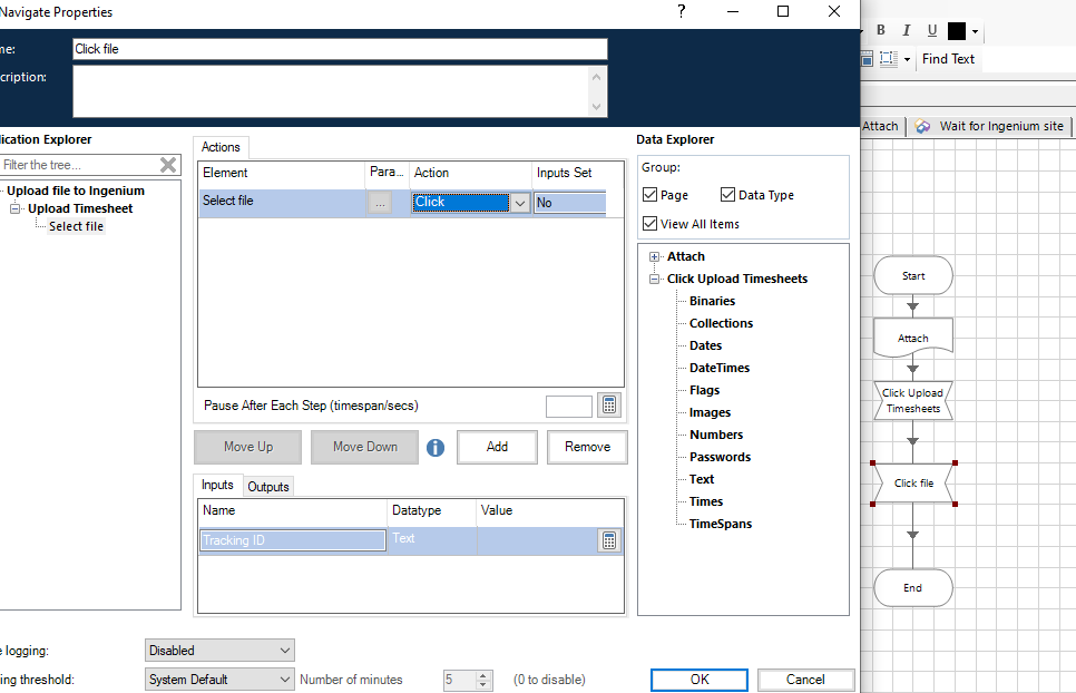

What actions have you tried to interact with the button? - Click

Did you get chance to verify whether by adding focus before click  and see whether it is focusing or not?
IF you want to  make sure the attribute selection in application modeller is working or not you can also use highlight action in navigate stage.
As other member mentioned in some versions of blue prism  based on browser extension  you might probably use tracking ID.
I would  try using Tracking ID . Tracking ID will be generated when you launch or attach.

I attempted to add focus, but I'm unsure if the bot is actually focusing on the "select file" element. I tried to highlight the "select file" area using the navigate stage, and I successfully highlighted it. Additionally, I used a tracking ID. Perhaps I can resolve this issue in the attributes settings?
Ace Rigor Santos
HI Ace
You can try below combinations by changing attribute selection in APp modeller as mentioned earlier if I'm using browser mode i try to avoid WEbPath/Xpath - Instead I use web text, Web ID, Web Element type  i'm suggesting based on  the App modeller screenshot shared earlier.
