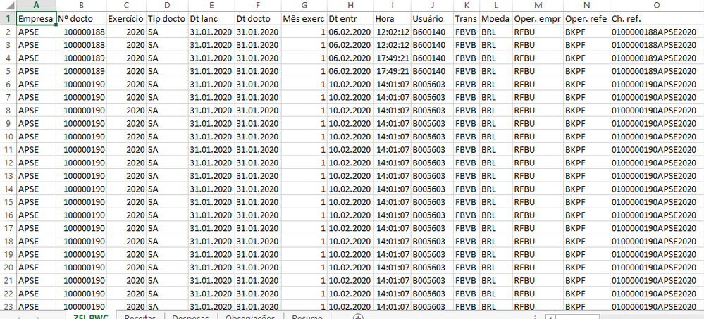

The normal table its only a sheet with the column name, and the lines,
This is my normal table:
And I use those register to generate the dynamic range.
I think its not working for dynamic range, because I can't put a filter in the first line

That is something I will need too.
About your question:
