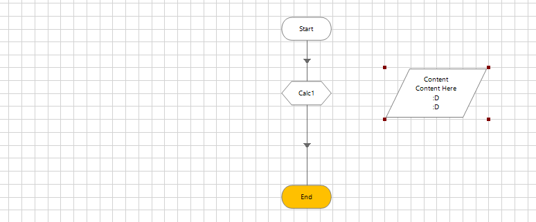

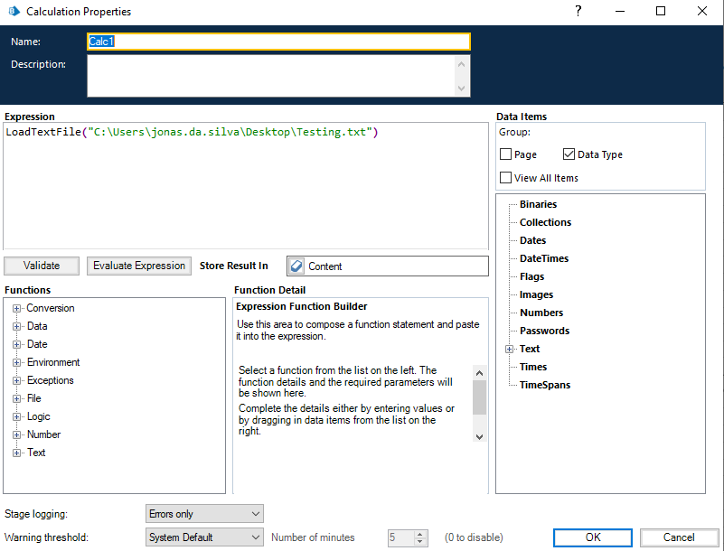

Hi, I hope you're well,
We often need to read some TXT files and we already know VBO for that, I came here to bring a "Hacker", a perhaps simpler way using LoadTextFile(), which can be used through a calculate stage.
You just need to pass the path to the file and you're done!
Hope it helped in some way.

20-09-21 06:05 AM
Hello Emerson,
I recently figured it out during my interview preparations.
Also, I have seen this function in 6.10 version.
Is it available on lower versions as well?

20-09-21 11:59 AM
@Ved Sengupta Yes its available for lower version also . If i am not mistaken i have seen this in 6.5 too.

20-09-21 03:58 PM
Exactly, with the Vipul said!! It's available in 6.5 to now
