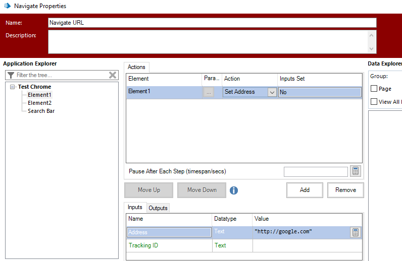

Hi Amlan,
I actually was hoping for the Navigate URL action as well, which was strange to be missing in Chrome/FF automation for so long. I'm not sure when it was added, but the other day I came across the action 'Set Address' in BP 6.9 Chrome automation. I've dropped a screenshot below showing this. I tested it a few times, and it does seem to work just as Navigate URL did before in IE automation. It seems to be slightly buggy, but it worked in most of my tests. Seems like BP should have brought this action up more prominently when they added it since so many people were still spying the address bar and sending keys into it for navigation. Oh well, I guess it's here now. 😃

Hi Dave,
Frankly I did not notice this action either in my comparison between Chrome/Edge/Firefox and IE mode. After looking into this closely, the backend ID of those actions are actually quite similar, the one for IE is called HTMLNavigate while the one for Chrome/Edge/Firefox is called WebNavigate.
I will raise a bug on this hoping the display name can be made consistent as to the IE mode.
